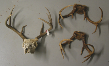

Hi All,
A friend gave me three complete deer antlers today and I have never made a pen from an antler. Any advice or link to where I can find instructions is appreciated.
Florida Don

Here is a picture of the antlers.
Florida Don
