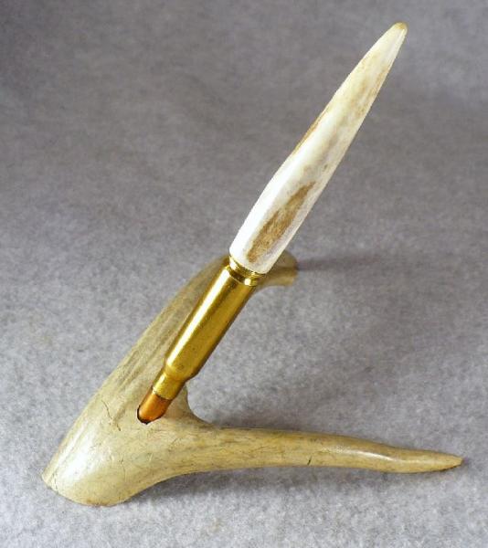

For this one I used a short tine. After I drilled it, used an old mandrel to hold it while I turned it down. I used a .308 cartridge since they are shorter than the 30.06.

I'm digging that pen holder. Talk about staying with a consistant theme.:biggrin:
Thanks. Getting the beam to set flat was a pain. When I delivered the set I told him I call it a horny holder. If you carry the pen in a shirt pocket, it's great for ... uhh scratching your nose with greasy hands.:biggrin:

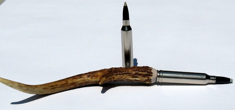

Rod; It is certainly possible to make a closed-end antler with the tine.This is an example of the pen I made recently for a hunter friend of mine.
When drilling the antler care must be taken to avoid breaking through the side of the tine. I drill a small divot in a wooden plate clamped to the drill press. Hold the blank with a pair of vise grips padded with a paper towel to keep from scratching the tine. Drill the hole only deep enough to clear the transmission and black top of the ink fill. You will have to use a pen mill to mill the bottom of the tine.
I use a closed end mandrel and turn off the bottom of the tine even with the cartridge. I then sand off all the bark on the tine. I distress the tine with file and a nail then apply a mixture of brown and black acrylic paint to the blank. This makes the blank an even color. Now seal the surface with CA and you're done.
