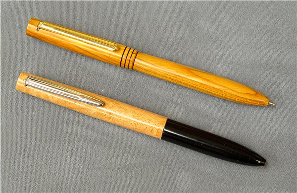

This is what happened when I closed both ends of the pen I copied from Don and Jay. Feel free to not like it. I don't either. Suggestions will be appreciated.

I agree with Chris the square top, also the length of the two pieces. I am not sure which would appeal to me, but the top either needs to be longer or shorter.
It is a nice looking pen.

Russ,
Far be it from me to critique your work!
An idea might be, if possible, to put a segment at the clip end of the material used at the nib end. That segment could have the slanted joint that you wanted for the middle, and perhaps would break up the look to some extent.

I think the flat top works, only because if it were rounded the pen would look entirely too long.
As far as the slant, you're going to need a normal joint as far as I can tell. I think the best bet would be to glue the acrylic to the wood at a slant, then cut and trim the acrylic a little further down. I think you can hide a joint in acrylic a little easier than the wood.

Russ,
Either a longer or a shorter barrel would balance the pen better and I think I would put the clip on the cap rather than insert it.
I am certainly not one to critique your work and the above statment only reflects my personal tastes.
Craftsmanship is nothing less than excellent as always.

Some accent lines (burn lines) near the top would probably give it a little more visual interest up there. As for the angled joint, why not fudge it? Hide the actual, straight joint in a burn line or cove, and have an angled lamination in the "upper" barrel?
Sorry...my unedited response was just a bunch of negatives, and I don't really like to do that. Over all, the shape is interesting, I love the recessed clip, and the craftsmanship is first-rate, as we've come to expect from you!
Thanks for sharing!

Thanks for all of the suggestions. I will try some of them and see what happens, but for now this will be another "for my pocket only" pen. The problem is that my shirt pockets are overflowing with pens.

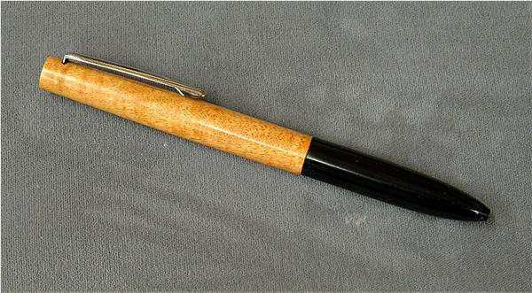

Here is that same pen with the latest version of my Russ-Line that sells very well and at what I think is a good price. It doesn't look quite as awkward when the clip is showing.

I do! I like it. Not sure a slant will help this one. I wish we could slant not only a small section at the top but the (non)CB joint as well. Of course it goes without saying that the quality of the workmanship is "from the other end of the counter." That's what my Dad used to say when we had something really expensive like real ice cream instead of mellorine.

I'm with Jim on the burn lines. It would match up better with the black bottom. But let's face it, who am I to say anything about a pen made by the guy whose videos educated me on pen craftsmanship.
