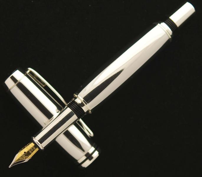

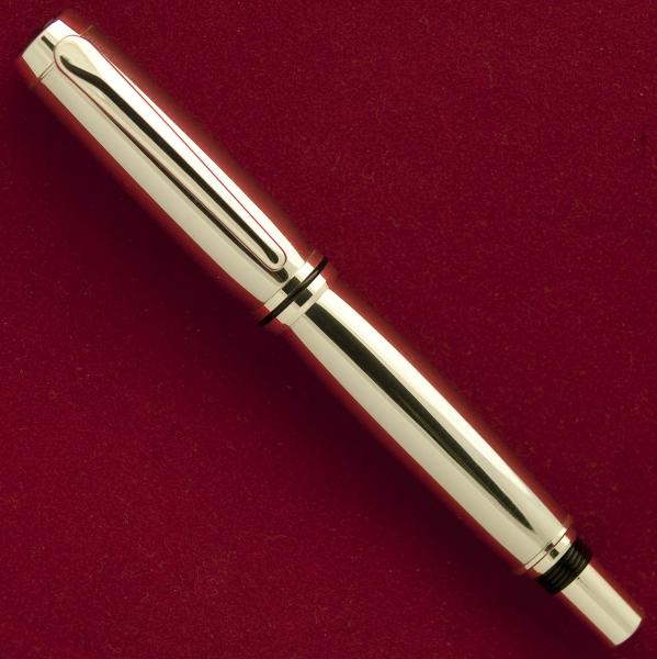

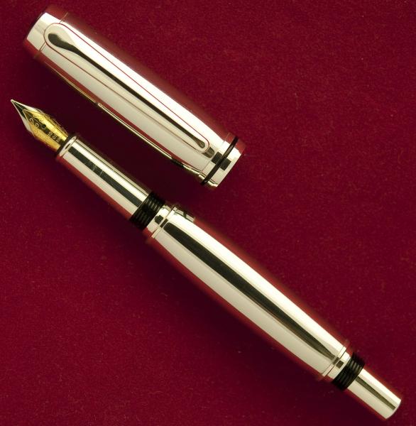

Made it this A.M. It's Aluminum on a Sterling Silver Navigator Fountain Pen. The aluminum blanks are from John Goodin AKA johnnycnc. Turned with carbide tools. Made this as a custom gift for my brother, a dentist, who wanted another version of a pen I previously made like this one.
To prevent fingerprints, I would have normally airbrushed it with aluminum oxide to get a matte finish. However, he wanted it "shiny". So to prevent fingerprints, I went ahead and put a VHT clear coat finish from Caswell Electroplating on the pen. I tried different color surfaces to take pictures on and went ahead and included both in the post. Hope you like it. Had fun making it and when finished it just looked like another "shiny thingy" to me. Comments welcome but most of all thank you for looking. Doc:)

Liking it a lot!
What did you use to finish(sand or whatever)??
BTW, like it on the red background, easier on the eyes.

Nice work Doc. Just enough contrast between the metals to not have it look boring, but shiny enough to look like it goes together.
I gotta say, on the pics though, the red reflection on the sides vs the black one in the middle (camera lens i'm guessing?) seem to detract from the outlines of the pen. The black is at least uniform across the pen.

I really like it. I agree on the contrast between metals, and I too like the red better than the black background. I have to squint on the black to keep it from being painful to look at. Excellent job!

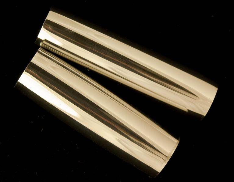

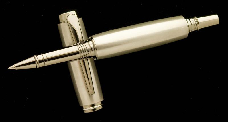

For any that are curious, I have attached pictures of some "shiny" aluminum tubes when done polishing (pardon the dust and fingerprints) as well as an Aluminum pen I have done previously with a matte finish using an Paasche Airbrush with superfine Aluminum Oxide. Regards, Doc:)
