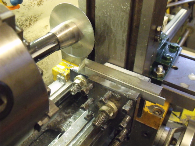

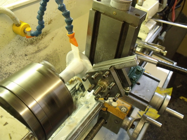

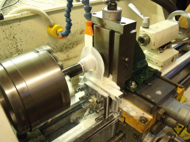

I've always advocated getting the biggest metal lathe you can, if you decide to get one. Here's yet another reason to get the biggest you can.
I needed to cut slots in my 2WTC pen and because my lathe is only a 10x21, I struggled to get the space.
The slot saw blades are 3 inch.
Eventually I figured out to use the tool post holder mounted on my vertical slide. It allowed me to do the horizontal and diagonal cuts without having to move the carraige.
It took 3 new blades to do all the cuts in the stainless steel:frown:
Oh well, at least I have another method of work holding to fall back on.:biggrin:

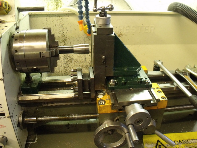

Skip the green 90 deg angle plate, is this something you made or bought?? Also do you remove the top slide from the cross slide to mount this??
Lin
skiprat
Passed Away Mar 22, 2022
In Memoriam
Oct 19, 2006
7,812
In a Skip in Wales
Lin, the device is called a Vertical Slide. It's one of the most popular tools that enables milling to be done on a lathe.
The top slide is removed and the vertical slide takes it's place.
This one has swivel base which makes it very versatile.

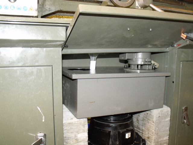

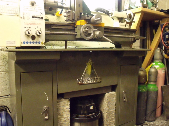

Ot response. That pick with the lubricant flowing has me curious. That is a lot of fluid (from the look of it). where does it go?
skiprat
In Memoriam
Oct 19, 2006
7,812
In a Skip in Wales
Mark, there is a coolant / lubricant pump system directly under the lathe.
I have drilled a big hole through the base and a large funnel catches the flow and takes it straight back to the tank.
Mind you.....a lot of it still ends up all over the damned floor!!!:biggrin:
Edit; Added a couple of quick pics:wink:

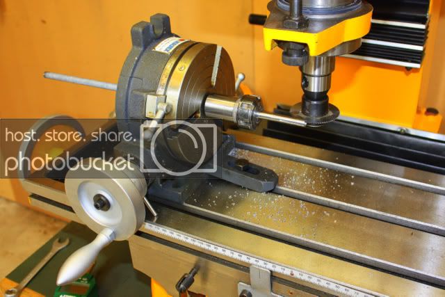

Love those two pens Steve, have come out great! though yes save up for a mill. i confess i should use my mill more than i do, though im currently not happy with my selection of tooling for it so it puts me off... have no rotary table or indexers for it... have most other things for it though.
Again, your making me jealous over your milky coolant... i miss the smell of it in a buckled way. used to go home each night stinking of it from the factory. for giggles i tried to drill out a piece of stainless the other week to see if i could pull it off withut coolant. i aborted after 9mm, glared at my lathe, and binned the burned out drill bit. For anyone who has never tried working with stainless, be impressed by these pens.. they are ALOT harder to do than you might imagine.
Ive just purchased a 75mm x 4mm cutting blade.. ITS A BEAST :biggrin:
