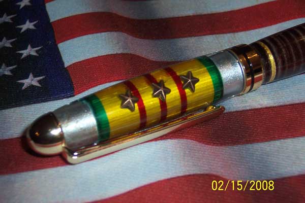

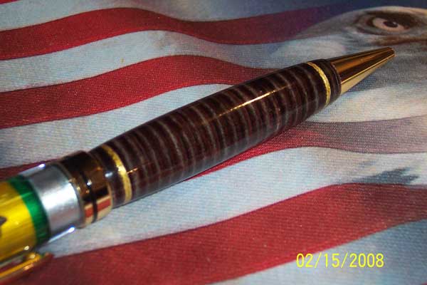

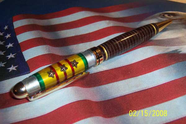

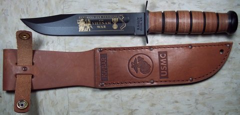

Another pen made using a Vietnam Service Ribbon. The stars are ribbon devices, used to signify the number of ribbons received. The bottom barrel was made using squares of leather stacked up to create the blank. This pen was made for my dad who recieved 4 vietnam service medals while he was serving in the USMC. The bottom barrel was to resemble the handle of a Ka-Bar knife used in the Vietnam war. Any and all crtiques and comments will be appreciated. Thank you in advance.

the stars, are they the actual stars? did they fit on the ribbon and throughout the turning and not come through?
i guess i'm asking, is there enough clear poly to avoid hitting the stars when your turning it?
jwalt191
Sep 26, 2007
54
Anna, TX, USA.
I have bought some more ribbons so I do not have to use what my dad has. I basically used the same procces as outlined in Dons snakeskin tutorial. (Very excellent). I statred by painting the brass tubes silver. Then I removed the ribbon from the mount, and wrapped it around the tube. I had to use Tackey? fabric glue, because CA discolored the ribbon to much. I next glued the 3 stars to the ribbon using the same fabric glue. (Next time I will try to get the stars straighter.) I then cast them using clear PR resin from Mr. Fiberglass. For the bottom barrel, I cut approx 3/4" squares from some nice Burgendy colored leather, I then punched a 1/4" Dia hole using a gasket/leather punch. The 1/4" was a little tight, but I was able to form them on the brass tube. Put each square on the brass tube with a layer of thick CA between, and use a clamp to squeeze them all together. After the CA cured fully, square the ends, and turn like normal. (Don also has a wonderful tutorial on this I just found the other day on the Pen Makers Guild. A little to late for this pen, but suprissanly similar.) For the 2 gold bands in the bottom barrel, I cut a small v type groove with my skew, and wrapped gold thread in the groove. Finish off with mor CA Glue and a CA finish, and it turned out pretty good. I did a Euro pen hoping the stars would not break out, and the rounded shap of the upper barrel held quite a bit also. I have some pictures of more ribbons in the different stages of cast, and if I remember, I will post them tommorrow. Thank you for all the great comments, and if you have any suggestions, especially from a guld member, hint, hint, Please lett me know. Thanks.

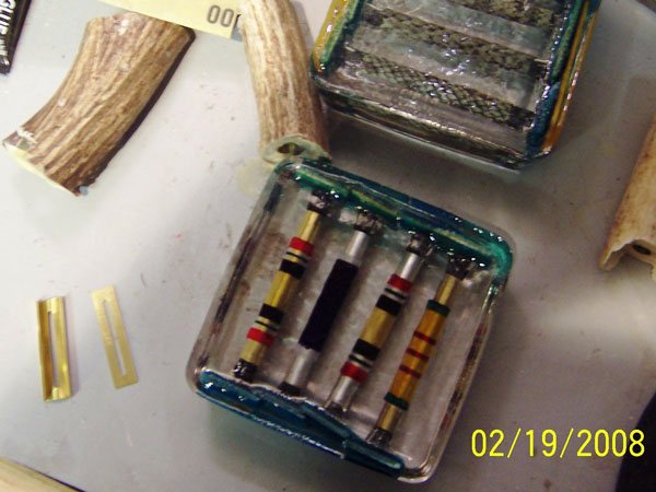

Here is a picture of the ribbons cast and waiting to cut up. From left to right are Iraq Campaign Ribbon, Puprle Heart, Iraq Campaign, and Vietnam Service Ribbon.
