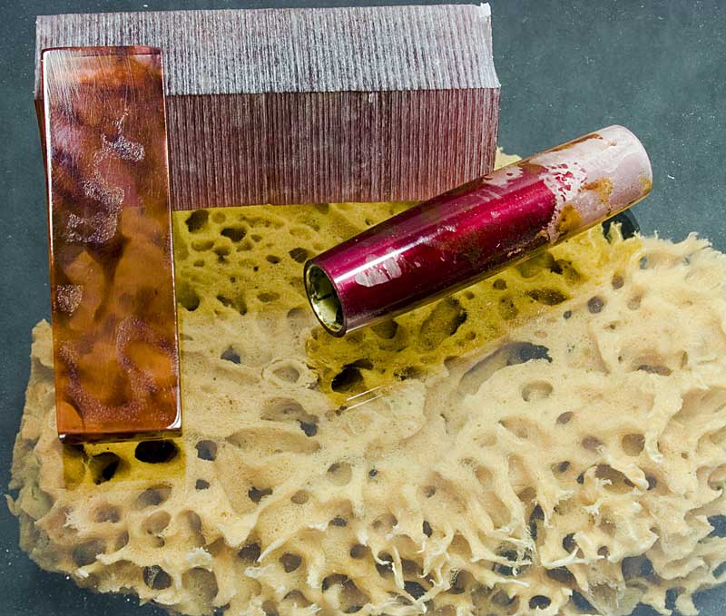

I casted this sponge here on PR. waited a day or so for the PR to cure. While PR cured I painted the tube with Candy Red enamel. Next day cut the blank to size, including the mold that got welded to the PR [:I] drilled the blank and glued the tube with 5 min Epoxy. I made sure I coated the entire tube and even then I got as you can see bad air pokets on the glue up.
What is you advise to prevent this?

I'm not sure I understand what your saying, but if i was going to cast that i would paint the tubs first, and cast them inside the PR with the sponge. When you drill the inside of the casting it will turn white on the inside and there is no easy way to polish it before you glue in the tube. To prevent bubbles you also need to cast under some presure.

Alex, did you also paint the inside of the casting after drilling? When I do my cactus blanks I always paint both tube and inside the casting.This way if any air pockets they will be between the two painted surfaces. Hope this helps.

I will try peinting the inside to the cast. The question now is if I paint the resin itself why would you paint the tubes as well. The pfoblem for me seems to be rhe air pokets not the color on the tube. I I paint the tub that itself should prevent the air to show and the paint on the tube as well should be blocked. Am I wrong?

Alex, By painting both tube and inside the cast any air pockets will be between the 2 painted surfaces and less of a possiblity that air would show with both painted. Also if you just paint the inside of the cast and not the tube the color is not as intence. By useing this method I have not had any air pockets on approx. 40 cactus pens.

Say no more That is it.
