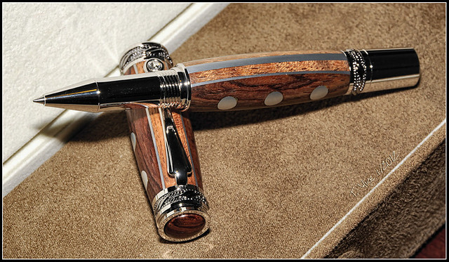

Nothing over the top, you've seen the other one! This one has Cocobolo on the outside, and Brazilian Cherry on the inside. Full sized Majestic with new finals turned and a satin finish over CA using steel wool. I had to do a second one of these knife concept pens to make sure I've got my head right for the next one which I hope is much more elaborate.

Boy, that is a GREAT looking Pen. Could not see what you call the knife part , but it does have the look of a knife as well. I assume that the metal is aluminum. Got my mind a going full speed. Frank
Well, when I say a knife concept it's more about the handle on a knife. I was doing some tests on mosaic pins a couple weeks back and was really inspired by all the work done in the knife forums. The 1/8th inch aluminum spine represents the blade. Hope that helps clarify my idea.

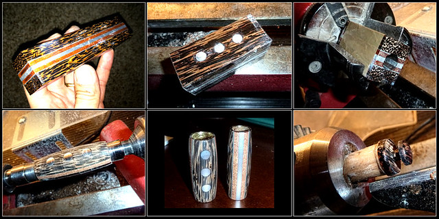

Thanks. Just kind of thinking out loud here but I am assuming that the main "backbone" 1/8" aluminum was one piece and went all the way through the original segmented blank. It was drilled length wise actually cutting it into two pieces after the drilling(If so I can see where the difficulty came from) I am wondering if the back bone was layered using two separate pieces of aluminum separated by the width of the drill bit with a piece of scrap wood the same width as the drill thickness and the same thickness as the two pieces of aluminum how well that would work? The separation would kind of act as a guide for the bit. Even if this method helped I agree that epoxy is probably the way to go glue wise and I will be more then glad to let you know how it goes.

Thanks. Just kind of thinking out loud here but I am assuming that the main "backbone" 1/8" aluminum was one piece and went all the way through the original segmented blank. It was drilled length wise actually cutting it into two pieces after the drilling(If so I can see where the difficulty came from) I am wondering if the back bone was layered using two separate pieces of aluminum separated by the width of the drill bit with a piece of scrap wood the same width as the drill thickness and the same thickness as the two pieces of aluminum? Even if this method helped I agree that epoxy is probably the way to go glue wise and I will be more then glad to let you know how it goes.
Here's the picture that shows it a bit better
Hope that helps...
Yes the photo collage is a big help. Another question do the "rivets" go all the way through, if so they sure did not help your drilling.

I found that it was easier to drill about half way through and insert the aluminum rods. Doing this on each side allowed me to have that balanced look instead of having a drifting bit.
