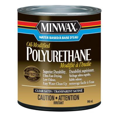

I use my "Dipping Method" with MINWAX Polyurethane to get a Fast, Odor Free, Durable, Easy to Apply, Consistent, Reliable finish each and every time.
Les
