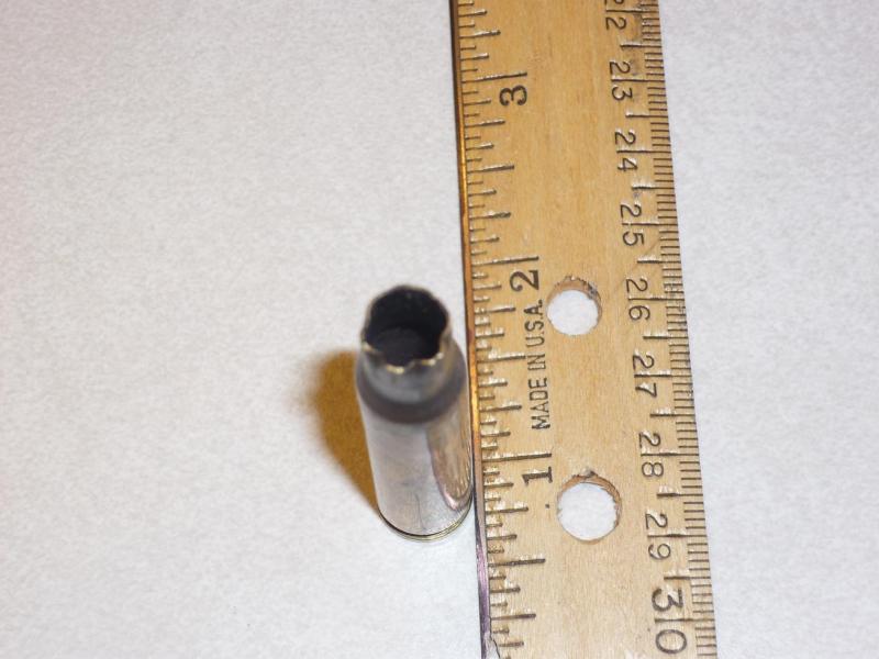

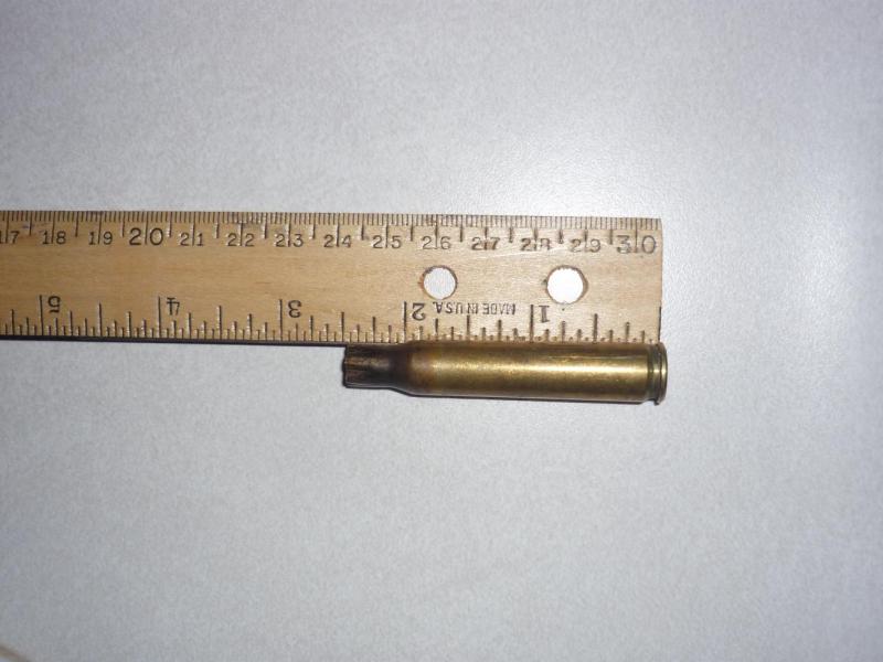

I was asked by a co-worker if I could make a pen using a casing that was fired at her step-fathers funeral, of course I said I could.
I read the articles in the library and searched the forum and still have questions.
First, how do I remove the crimping? Can I use my set of punches to round the mouth out?
I assume I can use the press fit ring at woodnwhimsies after I round the mouth, right? And then a slimline copper tip from them as well.
Is there any particular way to press the primer out and drill the hole?
I really need to get some to practice on, I'm afraid I'm going to wreck it.
Attached is a pic of what she gave me. It's a 7.62, same as a 30.06 right?

Jim,
That looks like a 30-06 blank to me. Be careful expanding the case mouth -- it will tend to break at the crimps. Punches may work, but I use a series of tapered expanding balls in a 30-06 sizing die to reform the shellcase.

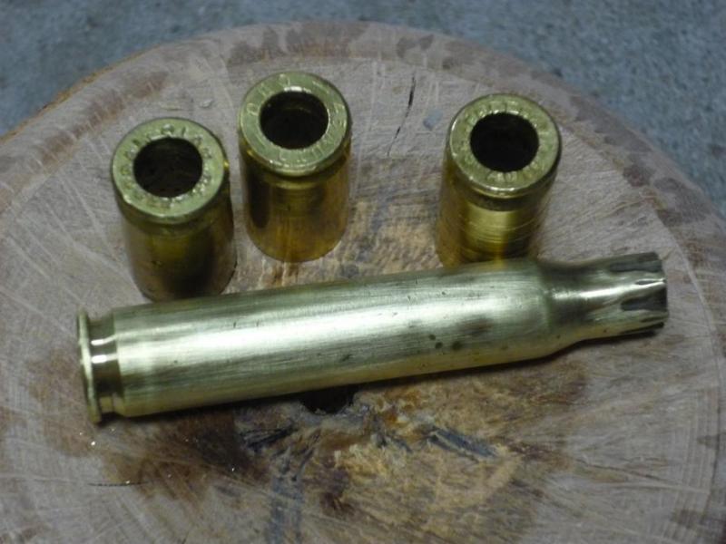

Here it is again, partially cleaned up.
Went to the shooting range to get some shells to practice on and they gave me some handgun shells since no rifles were shooting that day. Drilling on the drill press was surprisingly easy. I'm happy with how it's going so far, I'm thinking there's a snag coming somewhere, cuz this has been pretty easy so far. Now I wonder how to make a pen from all the 45cal casings I have.
I'll try and post one of the finished product.
