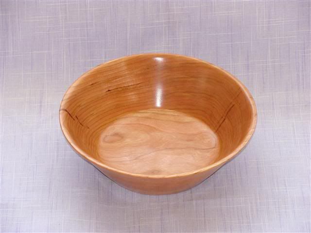

This was a 10.5 x 10.5 x 3/4" flat cherry board when I started it yesterday afternoon .
Rings cut out on scroll saw and then turned with a bowl gouge and sanded on the lathe.
Some dark markings in the wood that I do not care for at all but I am sure some will say it gives it character . .lol . . and whoever I give it to probably wont mind . .
We never know what is inside a piece of wood until actually getting in there.

That's a nice looking bowl William. I like the way the dark places lined up so well, sure looks like it was done from a solid block or log.

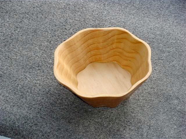

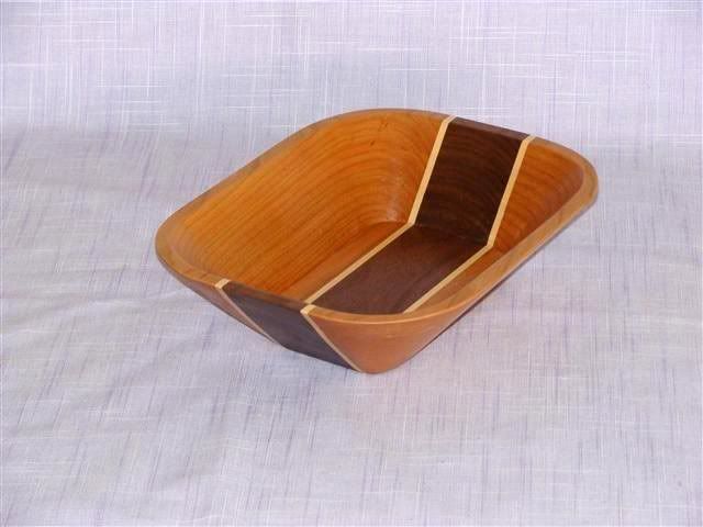

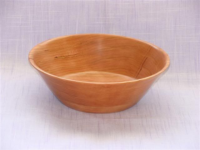

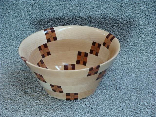

Here are a few bowls from a board I have done and only the round ones can be turned and sanded on a lathe. All bowls are not round :wink:

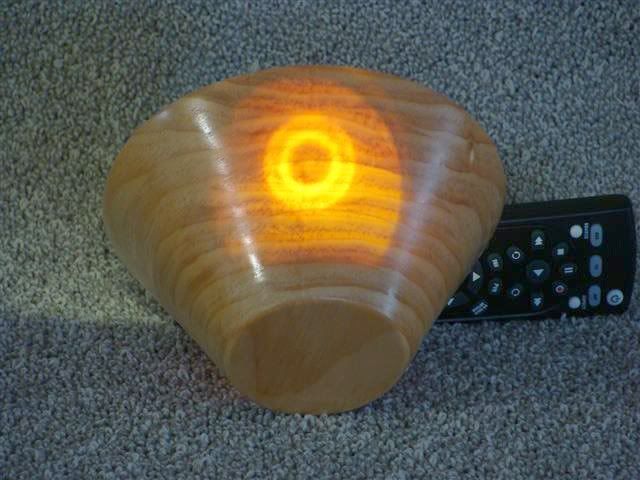

Here is one with a little flashlight placed inside to show how thin the wood was on that one .
