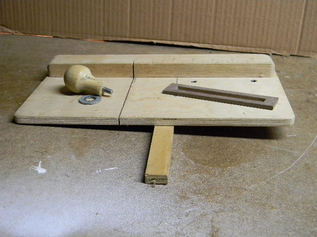

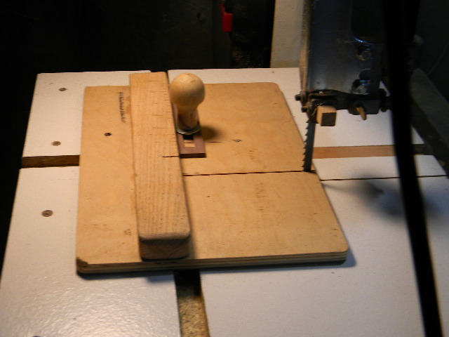

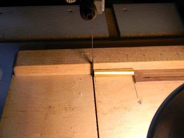

This is the sled I use to cross cut on my bandsaw. It is pretty typical, except it uses T-nuts through the base and a threaded knob to hold the length stop. I can set it to any length quickly, and use the studded knob to hold the stop. To cut a blank to fit a tube, I just set the stop so it is a little further than the length of the tube and start cutting.
I put another T-nut behind the fence to store the knob and stop when I am not using it.
