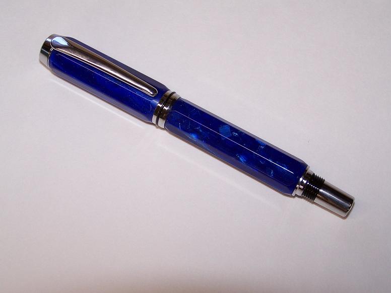

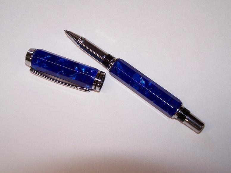

I have been trying to complete a scalloped pen for the past week and have met with nothing but failure. As soon as I get near the finished size it blows up so after three failures ............I am persuing another direction and giving my mind a break.
This is a Baron rollerball from Arizona Silhouette, the blank is an acrylic acetate. I turned it on the lathe and went to the milling machine and set up on a home made mandrel to cut the flats. This is much easier that those @#%&***@# scallops.:frown:
I hand finished the flats off the lathe. Any comments welcome good or bad.

I turn the blank to .210 larger diameter than the od of the tube. When I set it up to cut the blanks I have to deside how much to leave so I can taper it to the hardware. I set the endmill on the blank and then cut .050 to .060 off each flat which will leave .150 to 160 measured across the flats.. I set the spin jig to cut 45 degrees for the eight flats each cut will be wider than the finished width untill you get to the 312 degrees mark then they will all be the correct size.
I leave the extra size so I can taper the ends for a finished look.
Hope this makes sense.:confused:

Milling machine?
Can you share with us what sort of milling machine you are using?
Gotta say I LOVE what you have done here, really outta the box in MHO.
Great job!

Rolland,
I particularly favour faceting pens, to overcome two problems I
1. Mounted a small finishing Router on the quill stem.
2. I had a minilathe and dedicated it to the X Y table and fitted a 72 toothed gear to the head stock shaft to give a means of consistant spacing, fitted a top chuck on the head stock use a standard Mandrel and blind set it into a sleeve in the tail stock. Works great.
Send me a pm with your E Mail and I will send Pics.
Kind regards Peter.

Rolland,
That is a real nice pen. I have done a few octogonal pens, but I do them on the
Pen Wizard. I have not done an arcylic yet, just cocobolo. Let us see more of the work off your mill.
