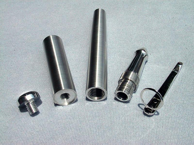

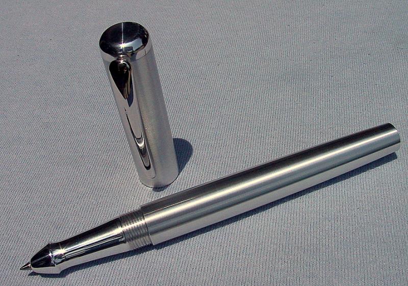

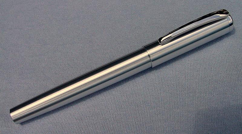

After the first try with the triple start tap and die I figured I try another one in aluminum. I made all the parts for this one except the clip. I think I'm going back to acrylics for a while after this one:biggrin:

Nice! What did you use to notch the recess for the clip?
I've tried dremel and file and still can't get it to look perfect.
I used to do it that way too. But like you, it was never quite the way I wanted. I built a bracket to hold my laminate trimmer (small router) on my toolpost and used an 1/8" router bit. 3/16" would have been perfect but I couldn't walk in and buy one:) So I cut an 1/8" slot then raised the setup a 1/16" and made another pass.

I can't wait to see that one in person. Did you cut both threads with a die on the nib?
Cris,
Yeah, I did. Of course the one is the triple start. I would have preferred for the thread into the body to be a bit finer. But I worked with what I had. I'll probably go looking for some finer one for the next one.

It may just be the photo, but it looks like the lower barrel is brushed aluminum and the nib is polished? If this is correct, how did you achieve that look, if you dont mind me asking. That really does look sharp! Very nice! And If you aren't happy with it, I would be happy to trade something for it!:biggrin::biggrin::biggrin:
Seamus,
The cap and lower barrel are both brushed. The nib and finial are both polished.
The brushed finish is 400 then 600 wet/dry sandpaper with some cutting oil on it while it's spinning on the lathe. For the polished I just continue on with an old set of micromesh I just use for metal. I go up to 4000 which looks pretty good then I use Flitz metal polish.
What I would like to try is the bead blasting that someone else (I'm sorry, I forget who did it) to replace the brushed finish. I thought that had a very intersting look to it.
I've always preferred brushed to polished mainly because I like the look. But also because it hides scuffs and fingerprints much better. Although, I thought the finial and nib needed to be polished to give it some contrast.
