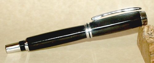

Nice piece of African Blackwood on a Chrome Baron Fountain pen...
Sanded to 2000 grit then 3 coats of sanding sealer and then Enduro...
This is going to be my everyday pen...

Wow, Tom, even though I can't see the grain, I find the pen rather stunning! I have some Blacwood and may have to make me one of those... I have a few Chrome Baron FPs too. [:D]

BTW, nice pen. All your pens are exceptional...what makes this "EXTRA" special to covet the honor of being your daily pen?

Thanks... feels good to get in front of the lathe again.. temps here have finally broken to a point that I can actually be in the shop and not melt... just hope they stay that way for a while...
I have not been using the enduro long enough to personally know it's durability.. but Wayne has been using it for a long time and I trust his judgement... one of things that I like about it is that you can have the finish done the second day... but you still need to let it cure a couple of days to get fully hard.. like lacquer... but a couple of sample pieces that I did show that it is a hard finish when cured and glass clear.. virtually magnifies the grain of the wood...
As for what made the blackwood "extra special".. NOTHING... I just liked the look and decided I needed a new pen to carry daily... [:D]
