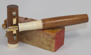

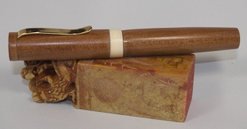

This is, as the title suggests, a fountain pen done in Ancient Kauri. The section, etc. are in ivory celluloid. I found that the Kauri is quite soft and will nick with as little as thumbnail pressure.
C&C gladly accepted.
Doug

Looks great Doug . I've done a couple similar but used Alternative Ivory , it threads nicely and seems to hold up well . The only thing I might have done differently would have been to taper the cap a little , the squareness of it looks to .....square . I've been trying to give my kitless work a little shape to it , flowing lines .

Wow! Nice pen. Both work well together on the materials. I like what you ended up with. Overall a very sharp looking pen!
