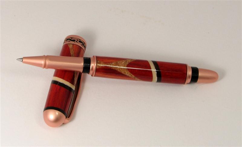

Ok, just to test the waters based on the conversation in the general forum, I thought I would throw this one out there for an honest critique.
I know of a few minor things that I have worked to correct in subsequent pens, but I'd like to see what sort of responses come up here.
Critique of the photos welcome as well :)

i like it, but it might have a better look if you make a sharper angle with the light wood. it would blend better with the other acents. it still looks good, don't get me wrong, but if it were a sharper angle, it might go better with the flow.

I dont like the way the pen kit "bling" interferes with the blank. The black bands on the kit and the details on the center band draw attention from a great looking blank.

I love the design and the finish looks fantastic.
Critiques would be it looks like at the centerband end of the cap, and the bottom end, it is a bit overturned, and you may need new bushings.
thats the only thing I can think of besides that I dislike your choice of plating, I've done away with all satin platings, and am down to chrome, rhodium, gold t/n, and black t/n, they just dont hold up well.
Also not a fan of the kit, but thats completly personal opinion, and shouldn't be viewed as a critique

I don't care for the band, it looks like it doesn't go with the blank for some reason.
Also I can't remember if the sedona band is supposed to be flush with the pen body or stand proud like you have it, and it looks like the blank is slightly smaller then the coupler in the Nib end.
As far as colors I think something with a little more contrast.

Fit and finish is very good. Blank matches hardware, color wise. Shape is pleasing.
I'm not sure about the segmenting. This is a personal thing and everyone has an opinion so not an issue, just my own liking.
Overall, very well done, totally sellable.

Good and welcome comments all.
My own personal critique.
This has some of the tightest glue lines we've done to date. No obvious joints where glue can be seen taking up a gap in the clamping.
I'm not a huge fan of the satin copper for longevity reasons and feel the dull sheen takes away from the overall finish on the body. Sellable but not the best pairing choice.
The band end of the cap isn't noticeably overturned when you run your fingernail across it, HOWEVER there appears to be a shadow line caused by overflow of the finish not being sanded completely back to the blank leaving it looking a bit off on the fit. The pictures seem to accentuate this more so than when you are actually holding the pen. I've adjusted the way I clean the end of the blanks after finish and before assembly and haven't seen that show up since. The same issue appears to be present in both ends of the pen body as well. Minor yes, but still something addressed moving forward.
The random segmenting is definitely a personal opinion. Chrissy has been doing a lot of experimenting with segments to see what works and what doesn't overall. I personally like the overall random look and the mix of woods but again that is personal opinion more than critique.

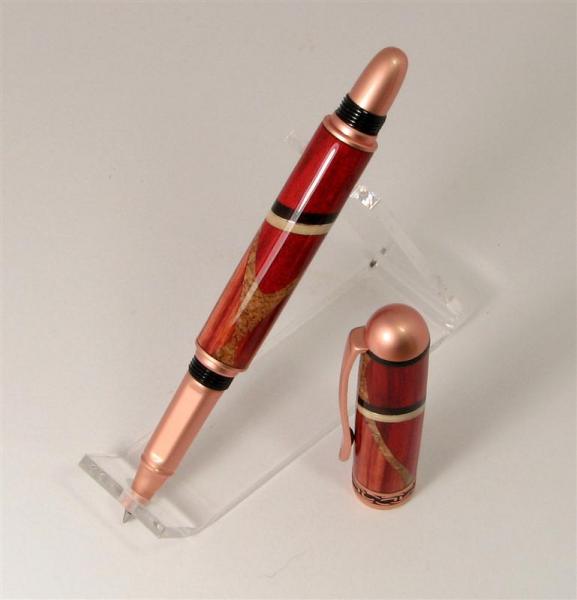

I love you work on the pen, particularly the interesting segments. I also like the Sedona hardware. What I dislike is the black threads. A "close up" photo would add to the interest in this pen.
When I make Sedona, I use the gold or silver threads from Rhinehart hardware. I prefer the gold threads on gold rings. It's a personal thing, but the black threads just look out of place to me.

Yeah my first thought was I wanted to see that blank on something like a Jr Statesman or Majestic kit. I feel like when you spend a lot a time to make a beautifully segmented pen you need to hurt you're wallet when you buy a kit for it.

overall , I like it . Not a fan of the satin copper . With the alum. inlay I think a chrome kit would match a little better. ( or leave out the alum. ) I do like the black threads with the black in th blank.

Glue joints look tight as you mention. It looks like there is an ever-so-slight bulging curvature between ends -- I like that -- not quite bushing to bushing and gives a pleasing shape without being out-of-proportion. The fit looked off to me as well, but you explained that above as being an apparent photo illusion due to the shadows. The black/silver/white bands look out of place. If anything, I'd think using copper/black/copper would tie in the black threads to the copper hardware at both ends of the body. The random segmenting doesn't quite do it for me on this one -- I'm thinking that there are too many random elements happening at once. Maybe consider randomizing the angles of the laminations but not the banded materials, OR randomize the materials but not the cut angles.

I find it hard to comment on a pen from just a photo. Some things you can see by zooming in on a photo aren't going to be visible to the pen owner unless they are looking at it with a magnifier. Other things that would become obvious by being able to hold it and feel the pen aren't going to be easy to discern by just looking at a photo. So, my comment on the pen is that "it looks nice as far as I can tell by looking at the photo".
Looking at the photo, I have a couple of comments:
1) I don't think the acrylic pen holder is doing justice to your pen. A better choice of props (or no props at all would) allow all the attention to fall solely on your pen.
2) Color is always a tough one. I think the warm tone of the background detracts from this pen. A more neutral or cooler color would allow the pen to really pop out. Based on the tone of the background (as I see it on my monitor), I'm guessing you need to work on your white balance (either while shooting or later in post processing (especially if you are shooting raw)). But it could just be that a choice of a slightly different toned background would make all the difference. It's worth having a couple different backgrounds in your studio.
3) Paying attention to your depth of field for the settings you have chosen and setting the angle of the subject relative to the focal plane to keep everything in focus will give better results for "documentary" type photos. These look pretty good, but the nib appears to be verging on blur in two of them.
Just one person's very subjective opinion. Others could justifiably feel very differently about these things.

To me, it looks like the main body is ever so slightly overturned where it meets the ring adjoining the section. Whereas the fit next to the finial ring looks right on, maybe a fraction larger than the ring, then rounded to blend. This might just be due to the angle of the camera to pen, close-ups would reveal the details better.
The photos look like the white balance might need tweaked just a little as the overall color is a bit pinkish. I thought this might just be the copper plating, but looking back at them. I don't know how much you can adjust your camera, but the one I'm familiar with has settings for different types of lighting then you vary the scale up and down for each lighting type to fine-tune it for the lights you use. So that could be worth checking out to see if you can tweak it just a little.

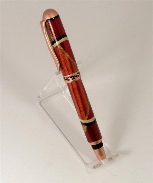

I need to get a good gray card to set the camera to the lighting. The only thing I really can't do is shoot RAW format. It just doesn't have the option. I have since bumped up my exposure 2/3 when shooting and it seems to do a little better. I may have tweaked it a bit too much in photoshop as well since one of my monitors has a bit different color representation than the other.
Love the comments and want to thank everyone for their honesty. I think going forward, coming out and asking for criticism is a good way to get solicit ways to improve. If everyone just says it's great then you don't always see how to improve.

Pictures look good in the composition you use, but if you were to not worry so much about composition, and more about detail, it would be easier to give it a better assessment.
For instance. It looks pretty good in the picture (This is judging F&F, without letting my personal tastes come into play), but if it were closer I would be able to see more detail. Even shooting the pen in sections as to give a better image for scrutiny would help. It may not be the most eye pleasing presentation that way, but it will allow the viewer better information with which to make a judgement.

My "honest feedback" for you is something I learned the hard way. You did a lot of great segmenting work and then put it on a relatively cheap kit.
If you're gonna go to all the work of segmenting with wood and metal and plastic, put it on a $25 kit that has plating that won't wear off and has metal threading.
Just my opinion after doing a lot of segmented pens with cheaper kits (not cheap mind you, just cheaper)...

I assume you are most interested in comments on the blank. The component set could be any of a half dozen or more that the blank would work with. Personally I would like Rhodium, Gold Titanium or Black Titanium better - but that is just taste.
I like the idea in the blank design and my comment might be more related to the photo than the blank. The lighter color in the design near the nib (not the stripes) doesn't seem to be defined enough, it doesn't seem to have quite enough contrast with the main barrel color and the color of the inlay or segment seems a little washed out itself. I won't say anything about workmanship, I don't think I can see well enough in the photo to tell you anything of value.
I would definately continue with that blank design though, I think it can be made into something really good and unusual enough to be very desireable.

Although not a fan of copper...this works well. The "silver" segment, aluminium, whatever, is great, but maybe a sheet of copper would fit better. The more acute angle thought is worth a look. Copper isn't my favorite...but this works real well!
