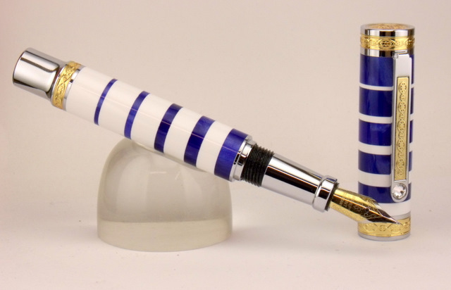

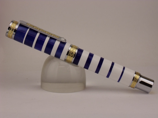

I did a very similar stripey arrangement a few years ago with a Panache pen, but I couldn't balance the stripes properly. This Empress kit is far more accurate although I'm not sure if I should or shouldn't have ignored the cb in the setup. ( I did ignore it here )
This is the first time I've used this kit and I am amazed at the amount of meat on the body!!! This would be an ideal pen for casting stuff in!! It's around 4mm thick.
Back to work tomorrow.....:frown:
Ooops.....it's actually an Empress, not a Princess Kit. From Axminster UK

Stunning Steven, I saw your previous one and this is definitely the better of the two.
Must have been a good few hours work on that blank alone.
Thanks for sharing :)

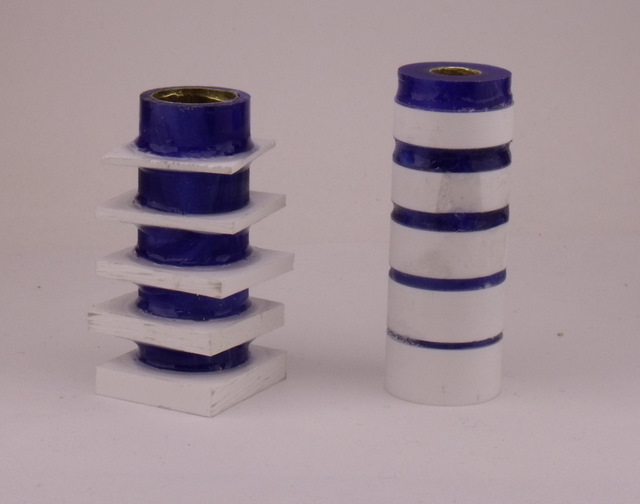

It took me longer to decide on the thickness of the stripes than to cut them and make the pen. :redface:

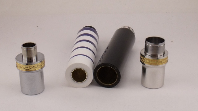

Here are a pic of the blanks and one of the kit that shows the differance between the body and cap tube.

Really great transition between the colors on this one Steven. There's an obvious balance to the pen and it looks amazing. I read on a kit review that there was a lot of open space on the lower barrel for casting on these kits. Still waiting to see what people do...perfect for spiders and scorpions I would imagine.

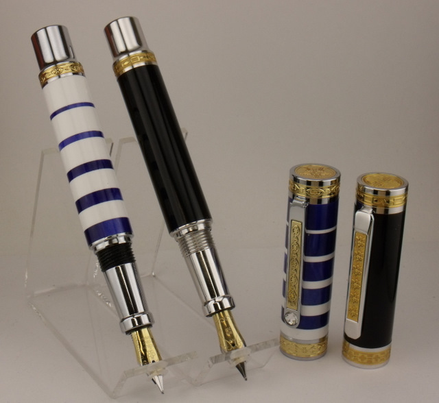

So this is the slightly smaller version of the full size Emperor??
Interesting question, so I just checked. The diameters and lengths are the same. The threads don't match and of course the tubes are different.
The kit pattern is 'similar' but of course there is no pimp stone on the Emperor. This Emperor is one of the numbered limited edition ones but I think it's the same as a regular one.

Just one question though, if theyre the same diameter and length, how do the tubes differ? Are they thinner, coming back to your comment re the 4mm of meat on them?
They say a picture says it all:wink:
I never thought I'd have to take a hammer and transfer punch to my one and only Ltd Ed Emperor !!!:eek::biggrin:
Edit in; I didn't want to keep bumping this thread to answer Terry's question below;
Neither with any ink, pump etc. Emperor = 41g body + 34g cap = 75g. Empress = 37g body = 32g cap = 69g. As both blanks are PR, I can only guess that the 6g difference is from the metal. I would have expected the Empress body to be more due to the extra blank thickness.
Nice job, Skip!
I live you pen, I just can't get excited about this hardware.
Nope, black threads. Also the clip and CB embellishments are not quite the same (in quality, at least).
The JR Emperor still has the gold or Rhodium threads, no centerband "thingy" and resembles the Emperor except of size and no pimp stone.
