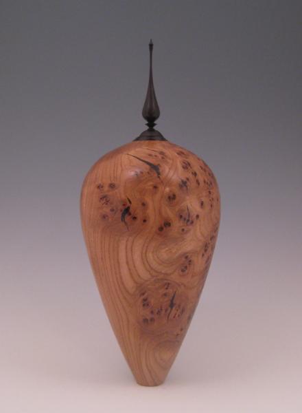

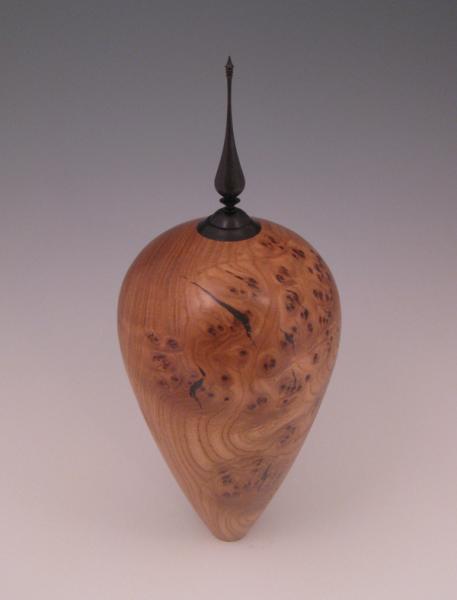

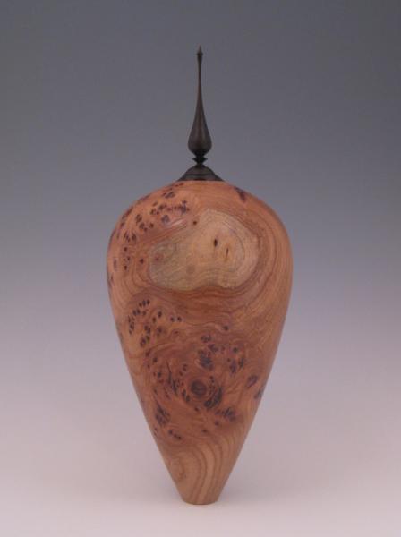

American Elm burl with African blackwood
See more from David Keller
David Keller
Nov 30, 2009
1,618
Enid,OK
This is from wood salvaged from a local tree trimmer's lot.
12.5" by 5.5"
Finished with shellac and antique oil then lightly buffed. The cracks and voids are filled with epoxy mixed with blackwood dust.
Comments and criticism appreciated.

Thanks, folks! Several of you commented on the thinness of the finial... If you haven't turned African blackwood, you're missing out when it comes to this kind of thing. It's easy to work and holds detail very well. It's probably my favorite finial wood especially when I'm trying to do something thin like this. With that said, they don't all survive... I break a few here and there when trying to go thin.

I roughed it out several months ago, DNA soaked, dried, and then re-turned it a few weeks ago. The form and finial were done on the same day, and I'd guess it took me about 5 hours in total.
