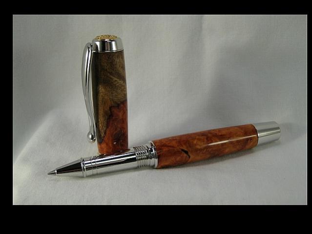

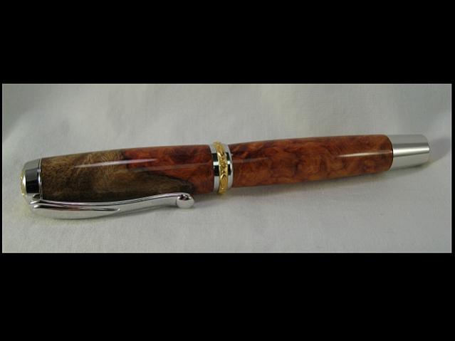

Second time I've posted some pics - still messing with the lighting (trying not to use a flash, still struggling to get it as bright as I want), but I think it's at least going in the right direction... suggestions welcome.

Put your photos in a program where you can play with the different aspects of them. Here is your photo in photobucket.
marcruby
Feb 22, 2008
1,175
Warren, Michigan, USA.
I don't know what you're using as light, but it looks like there's a slightly blue cast and it hasn't been exposed enough. Depending on your camera, you may be adjust those things with it's controls.
Lacking that ability get a piece of software that allows you to make some basic adjustments. I've never used photobucket but John's changes seem pretty effective.
Marc

Good job on the photo, and the pen. I have been working on the photo thing and getting the white balance is certainly challenging. Marc mentioned seeing a bluish tint to the picture. I don't see it much, but I am still learning to see these things without comparisons to other images. I guess my eye is not finely tuned yet; basically, you fooled me : ). I have also learned that different monitors can display colors differently.
Some cameras allow you to set a custom white balance that seems to work pretty good.
What is the finish on the pen?

Thanks for the comments and suggestions, everyone.
I'm using a Canon SD1100IS and I did use it's built in capability set the white balance -not the auto-adjust, it has a feature to set it based on current lighting using a white background - it was very yellow before that - actually I didn't have this problem at all when I used its flash, it was only when I tried to light things up myself. But Marc's right, I was very surprised how blue it came out given how white my scene was! I need to figure out what the best bulbs to use are so that I've got less of a blue light problem in the first place. I've got a combination of 2 35 GU-10 halogen lamps and then just a couple of utility lights with regular bulbs - I put white t-shirt material over the aluminum shade to avoid glare - but the bulb was one of those clear ones and it definitely has a bluish tint to it. When I have time I'll troll through the photo forum to see what I can find, but if anybody wants to offer a quick suggestion I'd appreciate it.
Anyway, finish is about 10-12 coats of thin CA, MM to 12000, 2 final passes with Kit scratch remover from Walmart. Kinda like the fish that got away, but gloss is much better in person than in my photos... ;)
