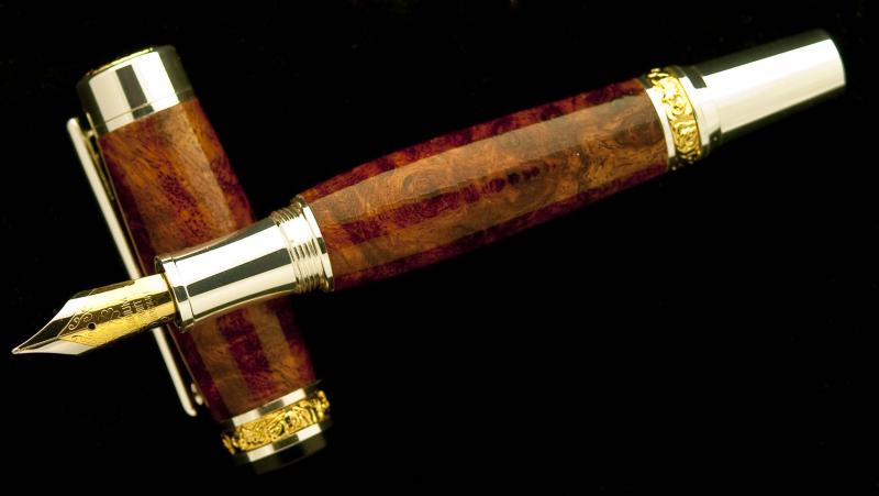

Made it very early this A.M. It's Amboyna Burlwood on a Sterling Silver Cambridge Fountain Pen with Gold Accents. For some reason, the black plastic centerband
did not bother me as much as usual.:rolleyes: This the last of the one dozen Cambridge kits that I bought at the beginning of this year from Woodcraft before Exotics started carrying them. Anyway, I hope you enjoy seeing the pen as much as I enjoyed making it. Comments are welcome but most of all thanks for just looking. Doc:)

Hey Doc. Beautiful work, as always. I always like logging in first thing in the morning and seeing one of your pens posted, it gives me a little shot of motivation to possibly try to turn something myself. Of course then life starts to have it's usual way with me. But hey, at least I Thought about accomplishing something :)
Nov 25, 2009
252
Ontario, Canada
Looks great to me!
Love the wood and the finish!!
The plastic centre band bugs the hell out of me.
For such a high end kit that costs so much one would think it would be metal.
But it does work on some kits and on others it stands out.
Andrew

Amboyna Burl always add a touch of class to a pen (or whatever else it's used on).
Sweet looking pen!

Gorgeous pen Doc, I love that kit, I just wish there was a mod to clean up the black ring, but that Sterling and gold combination is a beautiful kit for the price, and yours is a knockout.

The next Cambridge I do is going to be in Black Ebonite to see if it helps to distract the eye from the black ring.
