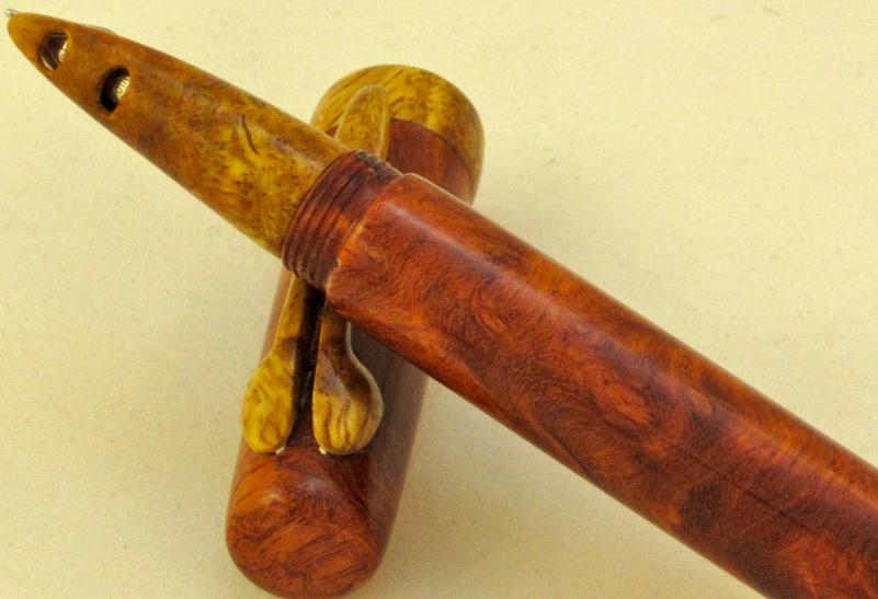

I decided to try and build a different style than I'm used to soooooo
I thought a kitless might be a stretch for me as I don't do them very well.

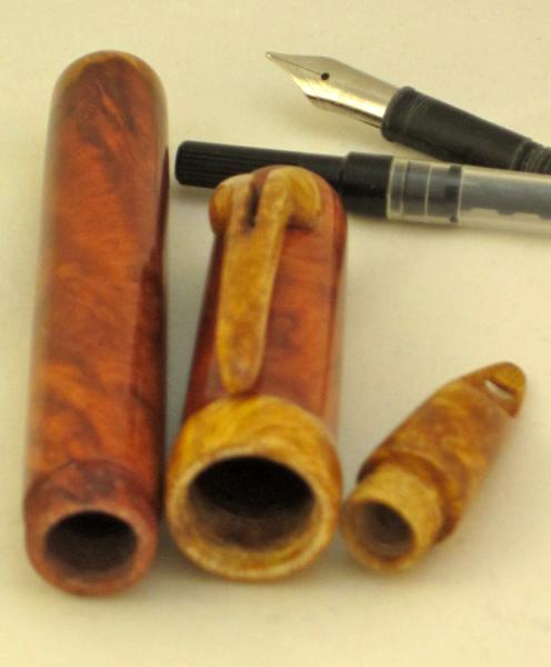

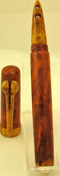

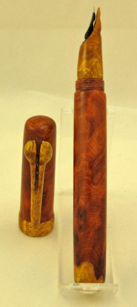

The hooded nib is hand shaped and drilled for a peek a boo look at the nib.

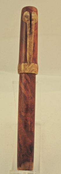

The clip is hand made from Amboina sap wood as is the thread skirt on the cap.
I rethreaded the section carrier to 7x1 mm to add a little more "tooth" to the wood section, and turned the section from Amboyna sap wood,Overall I thought it went pretty well.
Overall wgt 20g
overall length capped 147mm
overall length uncapped 126.8mm
cap length 61.5 mm
section to barrel 10x75
cap to barrel 14x1 mm
cap does not post
during the construction of this pen I discovered that I seem to have an allergy to this wood.
So this is my non tape pen,hope you like it.
C&C if you want
Mark

Ok Mark...the idea is amazing!!! The detail is perfect! The cap to nib attachment is a little off. All that being said...you did one heck of a job mister!!! Take a bow and a big pat on the back!!

Actually making the "hood" is pretty straight forward,cut the section leaving an extra 3/4 inch at the front. After drilling and threading the section as normal redrill the front 3/4 a little bigger(size depends on the nib size)
Cut the front into a shape that you like and sand. The holes were made by inserting a 1/4 dowel and drilling the top of the nib and a file was used to shape them.
have fun.

:eek:Wow that a cool idea! but... Isn't wood section absorb ink while dipping into a bottle of ink when using converter? I see converter in the picture.
