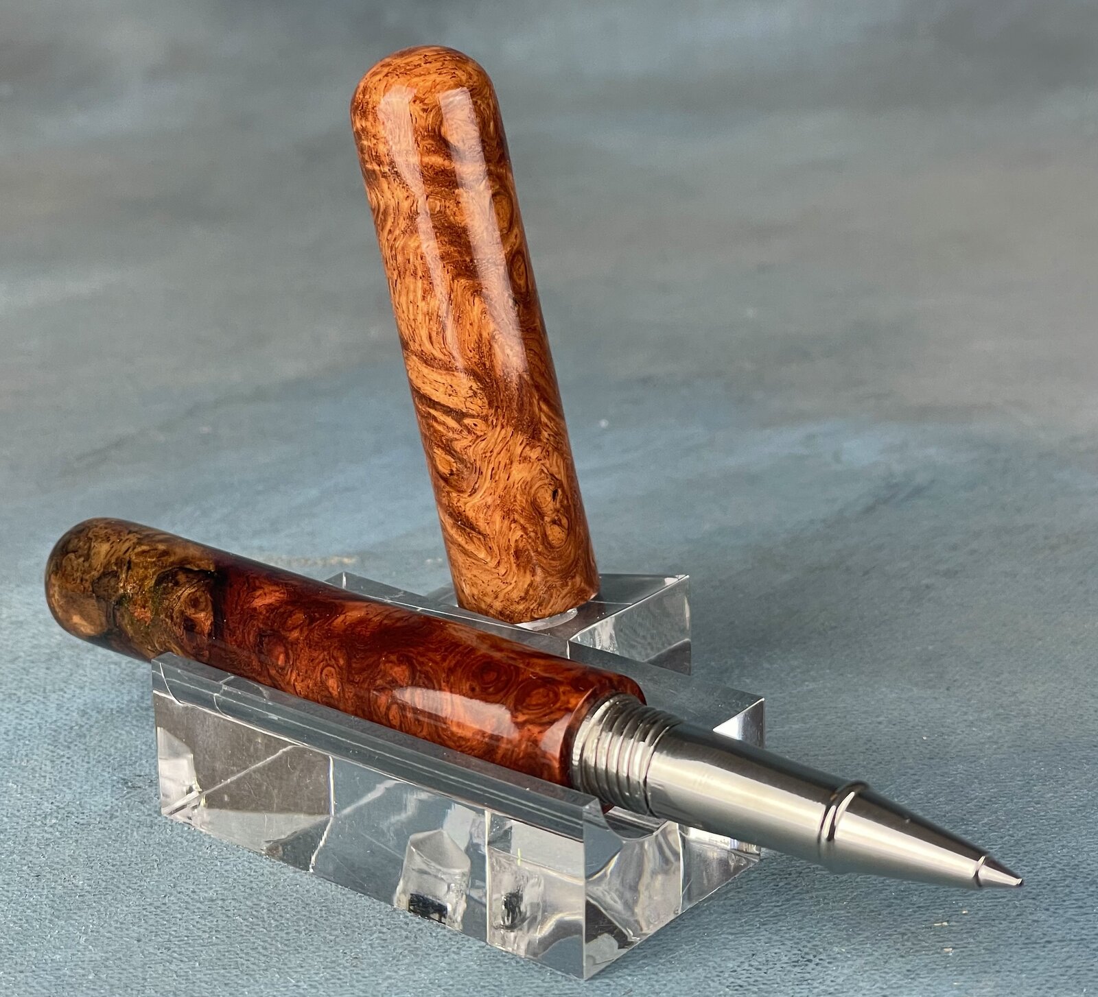

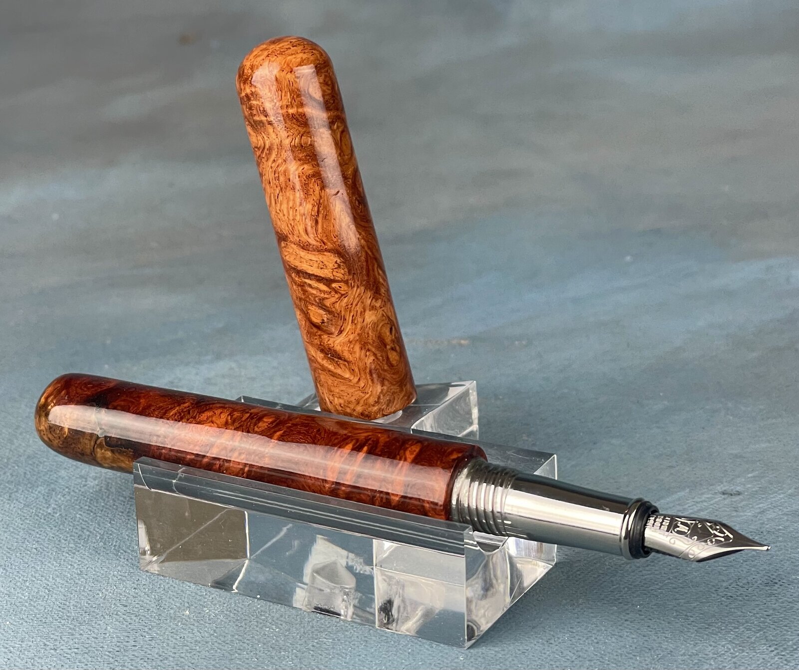

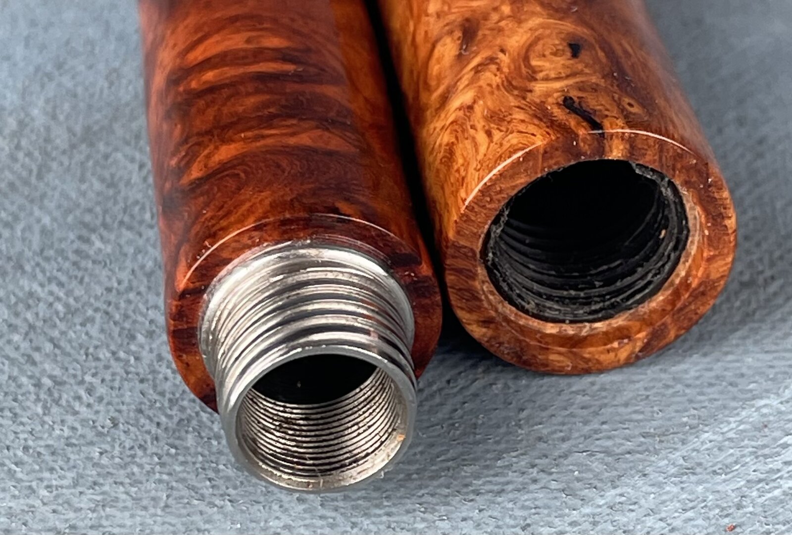

After blowing up the cap section on some very challenging amboyna burl I tried again. Thanks to Bullseye Turning I could buy just the cap insert. The $150 pen was saved. Thanks Kate!
Note - I will use FAR less epoxy glue to affix the stainless steel nib connector. I'm causing the problem, not Rick Herrell's stepped drills or Bullseye Turning's components.
I have learned that after applying finish (16 coats of CA) and waiting a bit, I can insert the cap into a pen jaw chuck and very carefully turn the rough end. After that, I turn the lip right by the stainless portion of the pen body to get it clean and flush. Thin CA is applied to the tiny raw sections in both areas and it now looks great to me.
How do you protect the finish when using the pen jaws? Paper towel/cloth/some sort of sleeve?
