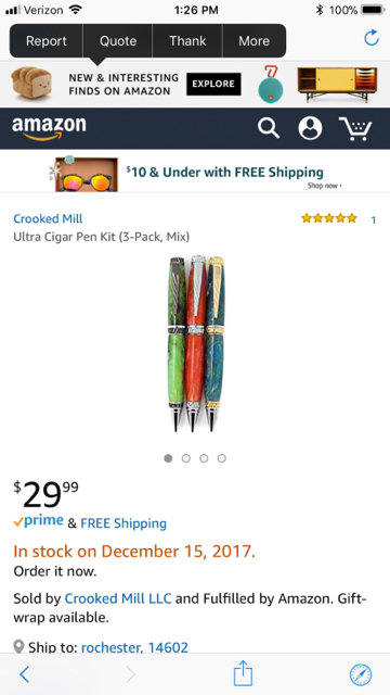

I recently picked up this pack (last one in the 1st link) and the quality seems on par with the kits from Woodcraft.
