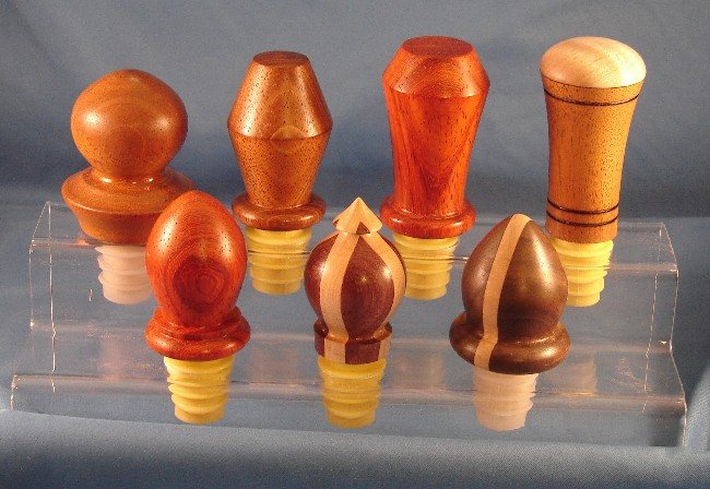

I got a 11/32" bit and using it, everything works just fine. The blanks tighten down nicely and hold well, I have to lightly sand the dowel before I glue it in, but it's a nice fit.
Turned these the other night -
<br />
Dave[:)]
