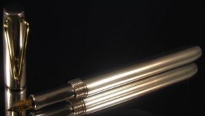

This Baron was made with blanks bought from Johnnycnc, I used a round nose scraper which I found was best for removing the most aluminium. :)

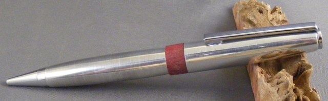

I have the Honor of the featured pen this month and it's an Aluminum and brass kitless slimline .

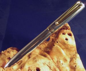

Here's another 2 Aluminum pens , with some brass thrown in for good measure . I use solid Aluminum bar stock I get from www.speedymetals.com
Aluminum and brass are very easily turned on a wood lathe (I use my Jet 1014vsi) . It requires sharp tools , carbide tools work better because you don't have to sharpen as often but HSS tools will work fine . Keep the rest close to the work and a tight grip on your tools and it turns like a dream .
It's best to use type T6061 which is a very machinable type of aluminum .

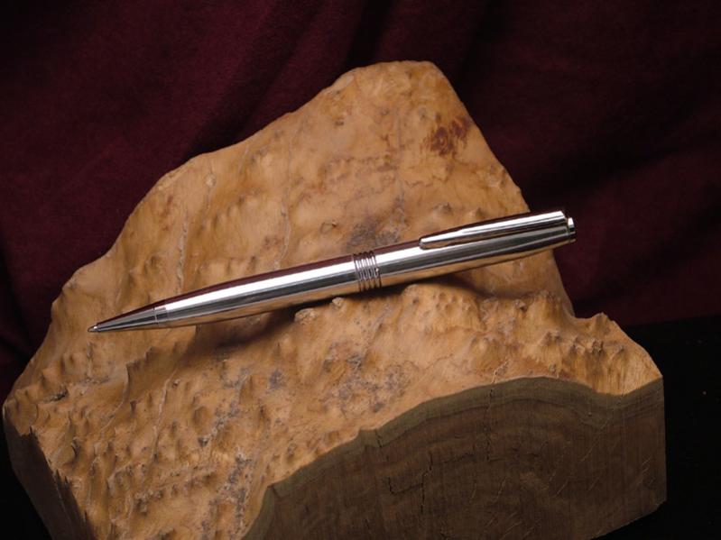

It depends on what type of pen you are looking to make. I made this one on a metal lathe. It started out as a piece of 1/2" bar stock. It has a slim line transmission in it.
