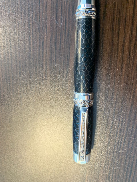

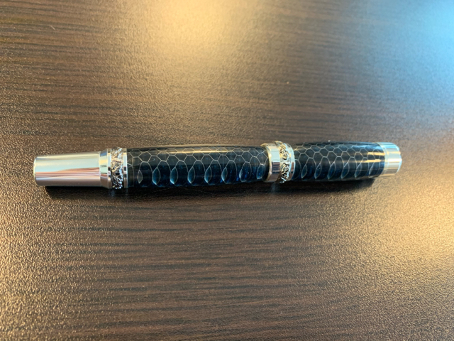

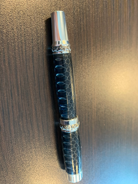

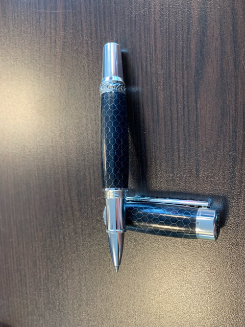

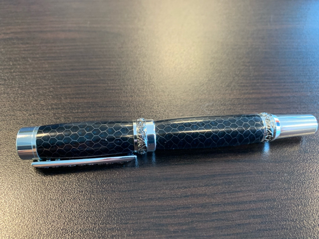

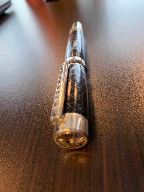

This was a hard one, but I love the finished result.
I started with Aluminum Structural Honeycomb. By adding Alumilite, black dye and deep blue mica powder to the Honeycomb and subjecting same to 55PSI of pressure over 12 hours, a 1"x1"x5" solid pen blank was born.
This pen blank was then carefully turned on the lathe. (An amazingly delicate process given the materials tendency to shatter along the aluminum joins.) Once this process was complete, it was wet-sanded from 100 grit all the way to 9000 grit, then buffed with plastic polish and finished with pure carnauba wax. The whole process from start to finish takes approximately 5 hours.
I'm very proud of this one so I thought I would share.
