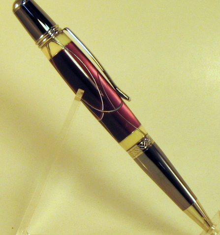

Drier vents work well too. For about $8.00 you get plenty of extra aluminum. For me, it made a sheet 10" x 12" or so. Made several pens so far. As has been said, scuff both sides and, use medium CA. DON'T squeeze it too tight when you clamp it. You'll push out the glue and, it may fail when turning.
