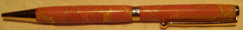

Here is 1 I turned over the weekend. It is a Miller Lite can cut in strips and set in Alumilite white.
