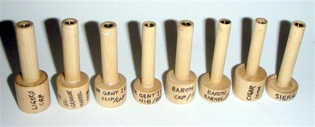

I made these adaptors for my 7mm pen mill. Some 7mm tube and birch dowel. Cut, tube and turn to size. Works great and it's cheap.
<br />
I still have more to make [:)]

Yours look much better than mine. They can also be used if squaring is done on a disk sander. The jig will have an old mandrel shaft and these shims can be used like with the pen mill.
