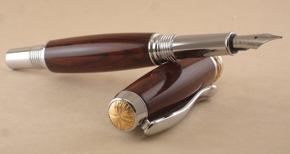

Check out the tutorial "pen finishing dipping method" by Les Elm in the library under Finishing. His pens have some of the nicest finishes I've ever seen. I have been working on my own "dipping method" using a different product. Here is a Cocobolo Triton using my method, hope this helps,
Bill
