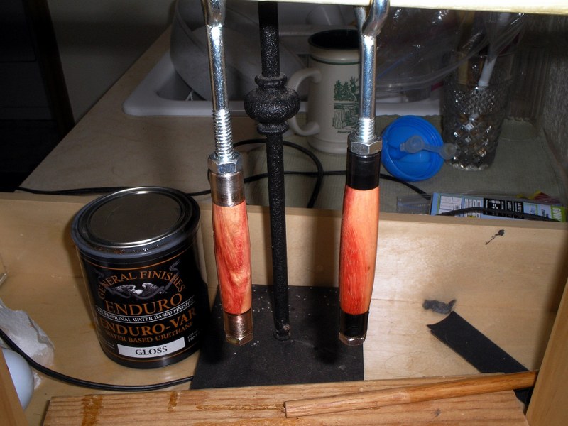

RHossack
Nov 24, 2006
362
Liberty Lake, WA, USA.
Eduro, water based poly, very strong and can be brought up to a mirror shine and last super long..it's an awesome finish. The downside is it takes lots of time to do. You need to apply many coats, and you should let it cure before you smooth and polish it. You can be looking at a week to finish a pen, but of course you can set up a system where you finish many pens at a time, so in the end the time spent is not so bad.
Jeff ... is this the enduro you typed about?
I use this and I 'dip' my pens and place in hot box and re-dip every 15-30 minutes as I remember and usually do 4 dips total and then let it sit in the hot box until the next day and use the brasso to polish.

RHossack
Nov 24, 2006
362
Hi Ron,
I for one would love to hear more details about your "hot box" ???
not much to it ... a multi-purpose tool.
1 x 3 oak frame, a cardboard box, table lamp with 30 watt bulb and a thermometer. I use 1/4" Eyebolts to hang the pens from while I dip.
Sits on an old drawer for airflow and it keeps it around 95Âş - 100Âş
MJ, the Ragdoll Cat helps ... he likes to watch the waterborne poly drip on the 2x4 base.
In the winter I dip in the kitchen because its too cold in the garage and he'll lay on top of the cardboard box for the heat.

RHossack
Nov 24, 2006
362
When dipping, I hope you're dipping just the tubes! Do you plug te tubes so as to not get the lacquer inside the tubes? Thanks for the info, I'm gonna have to try it.
No, I don't get any of the various dipping agents I use inside the tubes ...
I use 1/4" Eye Bolts with nuts and extra bushings. A nut, Bushing, Blank, Bushing, Nut and then finger tightened.
The bushings provide a capillary action and the Enduro and/or High Performance wicks off the blank.
There is no collar build up of the finish on the end of the blank and the bushings come off very easily when finished.
Hopefully this pic explains it better than my words.
okiebugg
Dec 5, 2010
264
Jenks, Oklahoma
Plexiglass finish
I've gone and done it. Plexi finish in the beginning is a trial and error proposition. Viscosity (IMO) is the key for me. After doing the melt, keep adding Acetone to the mix untio it appears like thin Tomato soup. After that, follow the above instructions.
I find the finished product makes a pen shine like a diamond in a goat's arse. It does require you to undertake a bit of a steep learning curve (and practice makes perfect).
What you end up with is a perfectly presentable pen that you aren't discouraged to show because of the finish.
One caveat. Any sanding marks left behind on the blank are almost magnified because the finish is SO clear
