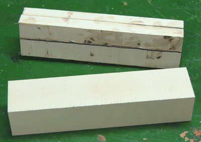

project saved
Well, as luck would have it, last night, after closing the big door on my shop I heard a ruckus. Went to look and came face to trunk with a genuine alternate elephant that got locked in. I think he may have been attracted by the corn I put out in the deer feeder. They aren't very large so I saw an opportunity to finish my pen with some new alternate ivory.
After wrestling him to the ground, I removed one tusk then let him go.
Shown is what I got. Enough to finish my Emperor, make another pen, maybe a Patriot and some that I segmented. The black in between is paper thin ebony. I'll attempt that at another time.
Watch for either my finished Emp. or a report of me going completely bonkers after blowing another blank.

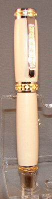

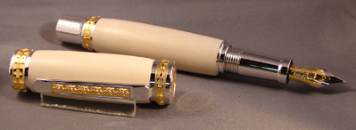

finished
Well, I finished it. For a while I thought the project was jinxed. Assembly was pretty straightforward except one part was screwed into a completely unrelated part and when I put it all in it was, of course, not right. I had a pucker moment disassembling without crushing or scratching the part. But it worked. It will be on display for sale in the gift shop soon. My highest priced pen yet. Of course, I hope it sells. But, a big reason I want it there is for marketing purposes. This will be the top end item of my 'catalog', priced at $340.00, a $120.00 pen will look very affordable.

pianomanpj
Sep 24, 2007
1,147
Augusta, Maine, USA.
Frank,
That is gorgeous!! I'll bet even that alternate ivory elephant would be impressed enough to sell his other tusk to buy that pen!! :biggrin::biggrin:
Very well done!!
