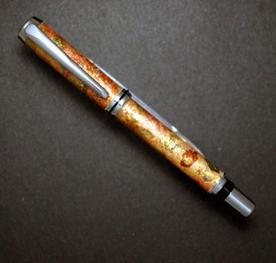

My wifes idea, lots of fun and pretty easy when you get the hang of it. 23K gold leaf baron.

So how did you make it? It is very unique and interesting looking. Depending on how it's made, could you make the same thing with silver?

<b>Making this pen was a breeze. We took Baron tubes, some gold leaf from the art supply store and a bottle of brushable CA. Many tiny bits of gold leaf stuck to your fingers later you have tubes covered in real gold.
The outside was a bit of a cheat albeit a smart one. We went up to pipemakers emporium and bought some clear lucite. Drilled it a hair over size, ran thin CA thru the insides of the pen and then slid the gold tube into it's slot. From there it turned like any other pen. Yes you could do it easily in silver, we plan to do it in all the mixed metal leaf colors you can get.</b>

Originally posted by huntersilver
<br />Hi Steve,
do you think it would work if you casted it in PR?
<b>Yes, actually I think that is the correct way to do it but this was a prototype and we were anxious to see one done. I think we will have our expert caster friend do that part of it once we get several sets of tubes ready.
I am fond of the lucite for it's strength, it is much harder to shatter accidently than PR but casting would make for a cleaner tighter finished product.
We are going to take this pen very seriously in our line, with patience whole landscapes can be done in contrasting colors of metal.</b>
