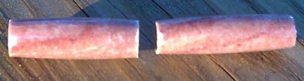

Originally posted by OKLAHOMAN
<br />Mannie,I can only guess what is happening but I had a very simular thing with a celluliod a month or so ago and the problem was the tube was not tight in the blank. In other words when I drilled the blank the hole was elongated at the ends and the celluliod flexed when the scrapper or skew got close to final shape and cracked just like your alabaster. This was because the bit was not sharp and the operator needed to slow down. Are you drilling thru or are you cutting the blank long and not exiting the blank? Check to see if you have a gap between the tube and the alabaster.
EXCELLENT observation, Roy!!!
I have done this, and just realized it!!!
There is a fine-line problem here. Looking at the cap on the gentlemen's pen (I believe), the "proper" bit drills the hole a good bit (pun intended) larger than necessary. I, too, have had it flex (Only I JUST REALIZED that was the problem). BUT, we try to make the hole large enough that, if the wood shrinks, it doesn't crack. So, perhaps we need to adapt our instructions (those copyrighted ones) to use a different size bit for plastics (and stones) versus wood???
INTERESTING, FOOD FOR THOUGHT!!!!!!!!!!!!
Thanks, Roy!!!!!!!!!!!!!!!!!!!!!!
