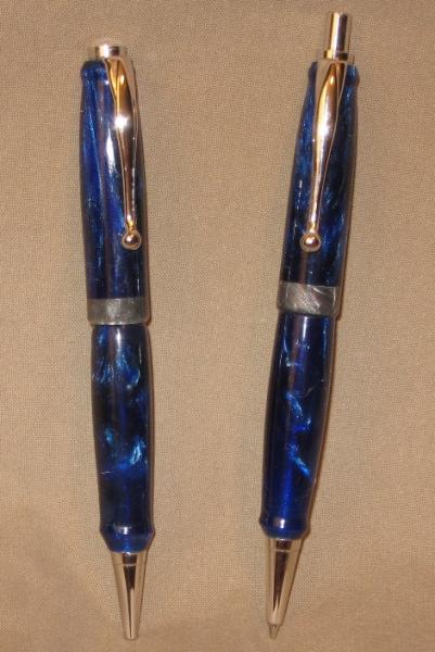

Here's a pen/pencil set I did for a friend whose son is getting promoted next week.
Maybe add a silver decal of the new USAF eagle...

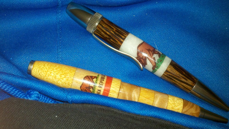

just made a few pens with my first "decals" (actually just address labels from Office Depot).
Some hobby shops sell waterslide decals for model cars, or Ive seen guys recommend decalpaper.com. Then you can put them on tubes and cast in resin, or get a fairly flat surface and put right on the wood/pen material, and build up a real thick finish layer.
THese are my first two. Also made a padre pen that started with wrinkles in my sticker. between every 5 coats or so i would sand with grit to help level it out. Ended up really nice.
as far as colors i would just segment acrylic or mix up a batch with the right colors if you cast yourself.
edit: there is no consistent line of glare or shine because this was taken at night in my lap with flash only in a dark room. THere is no overhead light to show a reflection. Enough CA glue completely covers the ridges made by the stickers.

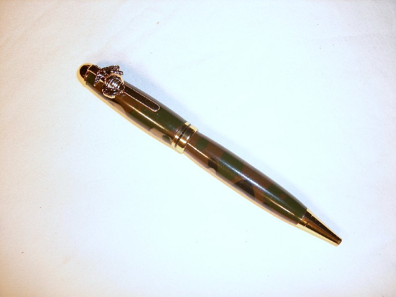

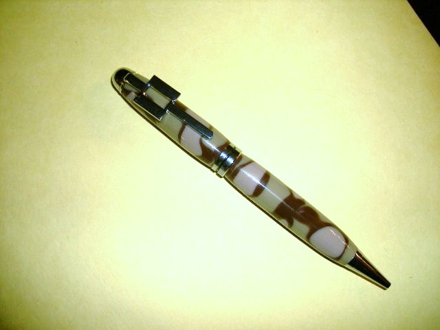

t001xa22
Jun 17, 2011
441
Arlington, TX
Like John said, the options are great using the custom clips from Wood Pen Pro. I have used them several times, and the clips are well-made. They also have combo sets that have a custom finial matched with the clip of your choice of branches of service. Please forgive the not-so-great photos; these were done before I built my lightbox.
