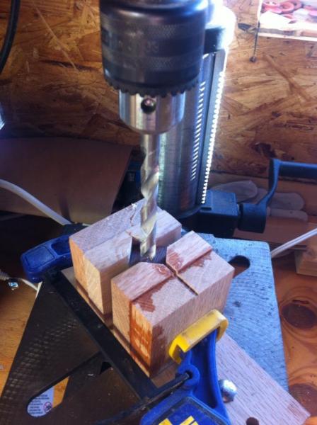

Tried to find the youtube video of what I used as a foundation; but as you would know it, can't find it. The creators main point though, was getting good cuts. If you take your blanks, and lay them on the antlers you should be able to arrange them to cut out most of the curves.
To drill them, I use my drill press. I built a jig to hold just about anything I can clamp it. The back part is attached and when doing square stuff can use the other side to make a good tight hold. You will have to adjust the antler some to get inline with the drill bit, a rotating table helps too. Some good practice is to get some round odd shaped tree limbs, and get a feel for getting everything lined up.
