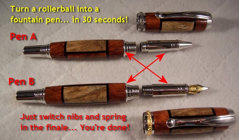

Jim, I started doing something recently that I think might interest you. For starters, I use the Jr. Gent and Jr. Statesmen pens from Craft Supply. Both pens are identical except for the fancy engraved appointments on the Statesmen pens. They both use the same bushings, blanks and all parts are interchangable, and that's important to me, here's why!
Rather than having to build several dedicated rollerballs and several dedicated fountain pens then hope the customer likes the woods you used on each, I just build a bunch of nice pens in various burls, acrylics, etc then mix and match to my hearts content.
Let's say a customer likes a particular burl color on a rollerball but wants a fountain pen. No problem, just unscrew the rollerball tip, remove the spring from the finale and screw in a fountain nib... their favorite burl is now a fountain pen!
It also works with platings with the Jr. Statesmen. Using the photo below, you can see how easily the nibs change out between the gold trimmed pen and the black titanium trimmed pen.
I now carry around a little box of extra fountain nibs, rollerball refills, nibs and springs so I can customize on the spot!
By making the Jr gents and Jr Statesmen, you use just one set of bushings, the same drills and create two nice pens, one nice mid price and the other an elegant premium price pen.
