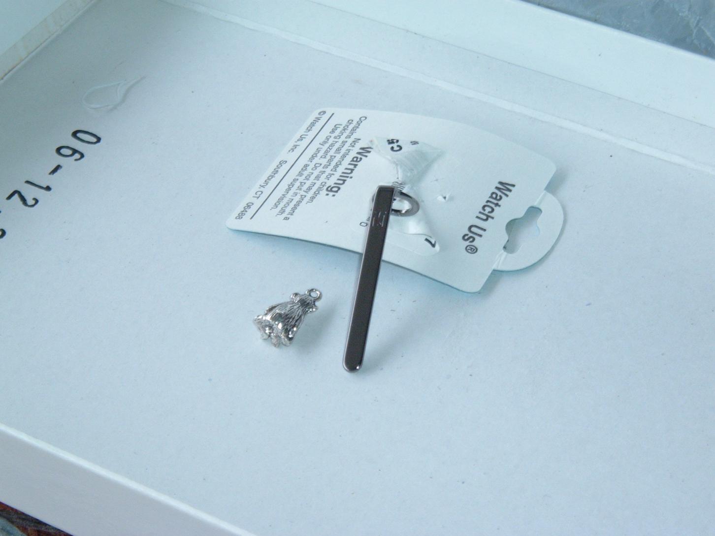

I would like to add a "charm" to a pen clip, but I'm not sure what to use to attach it. I have a pewter monkey that i need to attach to a "tin?" clip. It's a clip from a pk-penxx kit. I assume it is tin. How do I tell? I also have some other small metal decorations I would like to add to the clips but am unsure about the materials used. I was going to use thick CA glue, but after reading several articles about the fumes leaving white residue, I am hesitant to try that. Any ideas and suggestions welcome.

I am going to attempt to add a photo

it worked
Yeah, it worked. The charm is pewter, you can see the back is uneven, and the clip is titanium, I assume coated, it is from penn state.
I had a thought last night. What if I file a slot in the back of the charm just so the clip will fit flat and snug, maybe even recessed a bit. Then maybe use JB-weld to hold it on, or what if I was to use a fine torch and heat the back of the clip the the 488 F+, would it melt the pewter enough to hold it on? Yes, I'm aware it may not hold up to much use but I doubt the end user of this pen will be using it much, It will be more of a show off pen.

Pewter has a low melting point (231.88° C [449.38° F]) which is why I mentioned riveting.
Indian Jewelers supply as well as Rio Grande Jewelers both carry a low temp solder designed for use with pewter , might get lucky and not even scorch the plating on the clip, the solder has a reasonable joint strength,

Perhaps "flatten" the rear. drill & tap the clip, install stud, drill hole in "monkey", slid over stud with epoxy . . . . worked to add chrome stars to a Harley . . .

I was going to suggest something right along these lines. If you don't feel comfortable doing this, if is worth the probable cost (whatever it would be), maybe you could have a jeweler do it for you? Maybe something as small as a screw that goes into the arm of a pair of glasses?

A jeweler should be able to solder it on the clip , they do make low melting point solders for soldering pewter that would work and make a fairly strong joint .
I made a pen for a customer with a pewter Pooh bear holding a honey pot (a charm from a broken bracelet she had , I cast it into a clear finial (like yoyospins Doohickeys)and put it on the top of the pen , it was a little big but looked nice (wish I had taken some pictures) she just loved the pen .

It looks like the charm has a depression from the back side. fill the depression with solder and file it flat then either solder it or use a drop of CA, but cover the other metal with painter's tape so the fumes don't whiten the metal. Let it dry overnight and then remove the tape.
