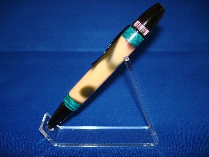

Here's a pic of my salvaged pen after I blew both ends off. Used scrap cutoffs to segment it. Turned out pretty nice I think.
<br />

Chris,
That LOOKS like one of the "cats"!!!!!!!!!!!!!!!!
There is no more forgiving material than that!! Sharpen your tools and start from the center of the blank to the edges. Ride your tool's bevel (assuming its one of the gouges or scrapers) until you contact the blank and take light cuts until you have done a few and can confidentlyapproach it.
(If you're not careful, I'll have to come to Florida to SHOW you what I mean!!!)
Take a deep breath, have a cup of coffee, and start over - you'll get it!!!

Yep... my blowouts were totally my fault. It was my first piece of resin from Ed and I just got too aggressive with it. I didn't want to throw it away so I came up with the parting off the ends and gluing new ones on. I subsequently got less aggressive... sanded the next pieces into an octagon shape before turning and used a whole lot sharper tool with a lighter touch and got just continuos curls off it. To the point where I had to stop the lathe to clear them. Looked like Easter grass. I like Ed's idea of starting in the middle and working out also. I was going end to end and back again. Also, sand paper works well if you keep it moving. It's all a learning experience and a darn good one if you ask me. I've got a lot more to learn too [:D]
