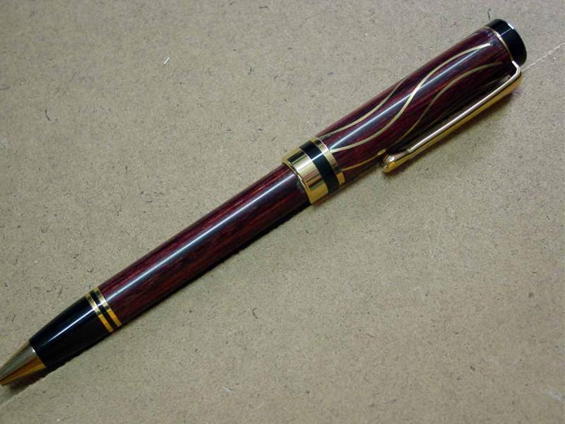

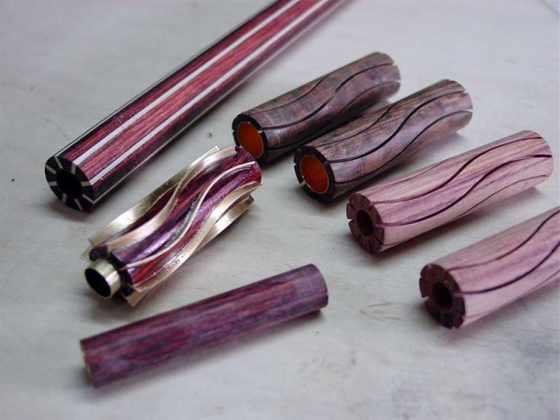

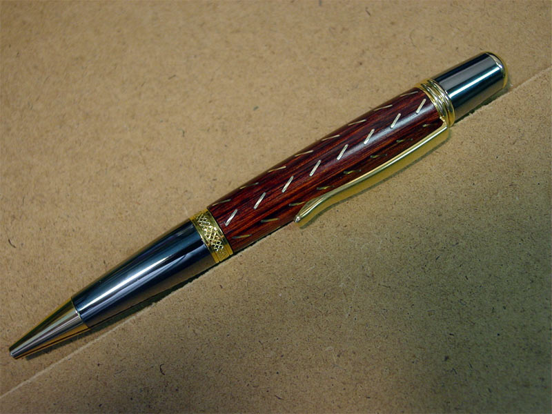

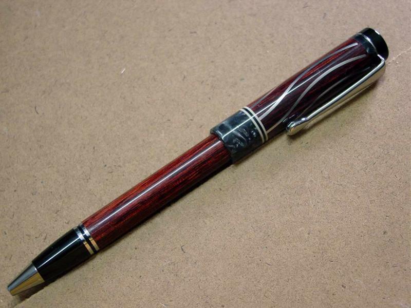

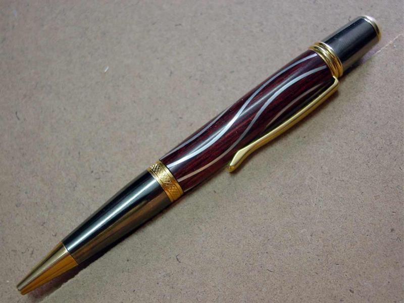

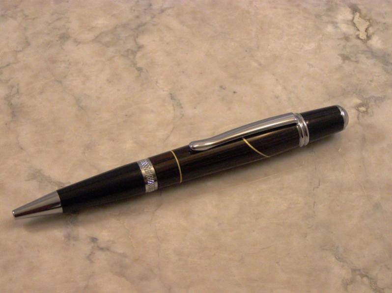

I have made many pens with metal such as Aluminum and Brass in wood and Corian.
Most worked well but the metal will drag into light colored wood and is hard to keep it clean looking.
I did one pen with Aluminum in Corian and I could not get the Corian to polish next to the metal strip.
Metal in a pen looks very good but has its special set of problems to be overcome.
Here are some photos of metal in wood pens.

HOT DAMNED!!! That's some SEXY 4th axis work you have there... I really like the wavy billets!!!
