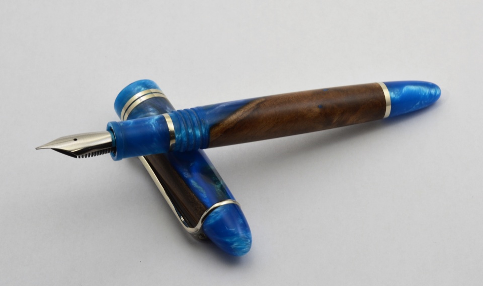

These aren't Acme, but similar concept. I find they have great appeal to me over multi-start threads, as being single start, if I have grain or facets that need to line up when the pen is capped, these allow them to line up every time rather than having a 1/n chance of alignment as with multi start threads. I cut these on a metal lathe.

That Pen looks nice John!
