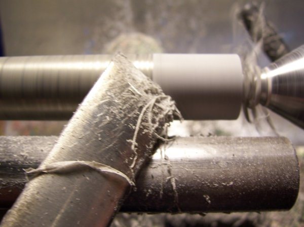

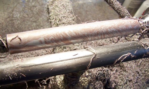

Depending on the flavor of m3 blank you have, I would say you can expect light powdery ribbons like I got on the nickel silver blank below. Notice I used a typical Sorby skew, no need for anything special.
More light powdery ribbons.

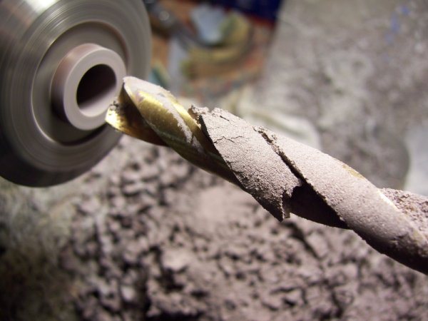

And when drilling, expect easy drilling similar to ebonite and you might expect to see powder like the mokume gane blank below, not metal shavings burning up bits like many expect to see. Like ebonite, these don't like heat so drill slowly.
