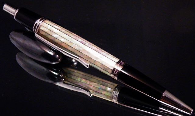

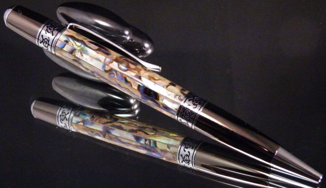

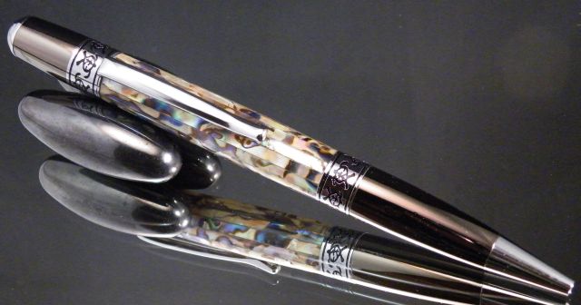

These are a couple of Abalone pens I've made with my new shell saw . For the past few weeks I've been working on a saw that will allow me to cut shell strips to a very exact , repeatable size to cast for making pens . I've finally got it set up right and this is the result .
Paua Abalone Honu Pacifica . Thin strips of Paua Abalone cast in PR . The colors in these shells are awesome , they shimmer in the sunlight . The shell strips are set on the tube and then sealed to prevent air trapped under the shell strips from coming to the surface of the shell strips . Each blank takes a couple of hours to create but the look is well worth the time .

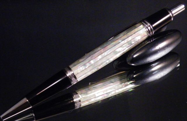

This one is Japanese Awabi Abalone on a chrome Sierra click . Awabi is an awesome shell , it's basicly similar to White Mother of Pearl except in the light it shimmers in purples and greens and golds and .... This is one of those imposible to photo shells so these pictures don't do this pen justice .

It's funny but the Awabi is actually the nicer of the two . I can't get the colors to show up in the photos but they really are awesome , they shimmer and shift through colors as you move the pen and look at it from different angles , kind of like the color shifting car paints .
