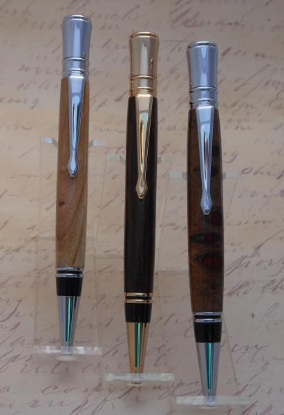

A trio of Executives

A black wood, A Cheery wood, A Banksia Nut. All finished with WTF. An experiment on how the finish works on a very dark wood to a light wood. I was hesitant to try and make a slurry with it to fill the imperfections, voids in the banksia nut, but will on another porous wood. The light wood i am pleased that it did not alter the color. The dark wood came out well with some grain showing. Carl
