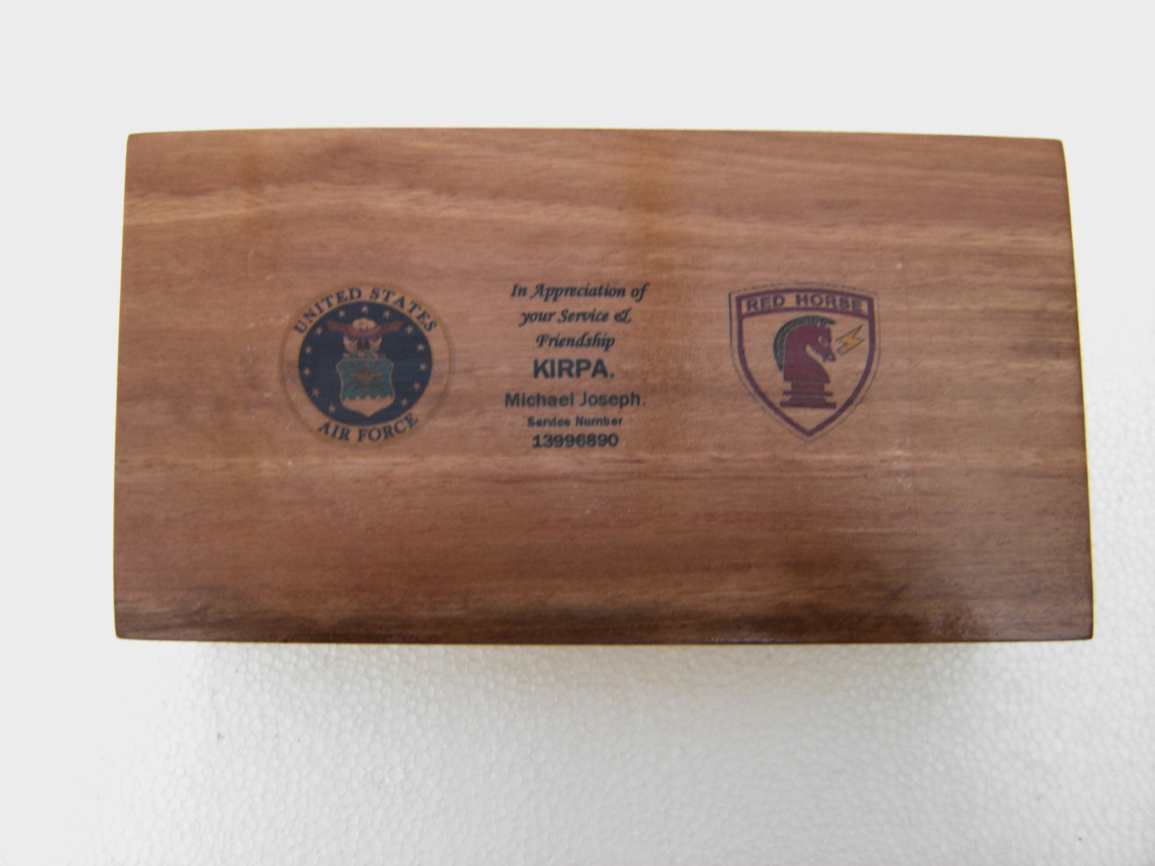

For Mike I made three pens, and a Presentation Box, with a Water Slide Decal, of both the USAF and "Red Horse" Company Badges, his Name and Serial Number, together with a Small Message.
I initially intended the box to represent a Munitions Box, enclosing the "Arsenal", but when I milled the Timber, the Quality was too good to cover with Grey Paint, so I decided that would be better left natural.

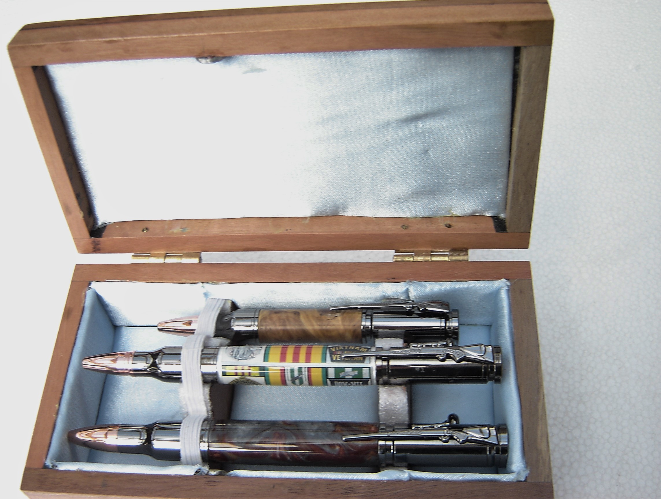

I used Eucalyptus Robusta aka Swamp Mahogany, however I struck a problem with gluing the Timber, regrettably the Tannin in the timber reacted with the water based Acrylic Adhesive, and the glue joints turned a deep black, as did the parts of the Box where the glue got onto the timber.
This was OK for the outside of the Box, as I could sand it, however the inside was not possible.
So I decided to line the inside of the Box, with a Padded, Sky Blue Satin Lining, and mount the "Arsenal" on inbuilt Cradles.
Lid of Presentation Box. With Water Slide Decals

Presentation Box and Contents

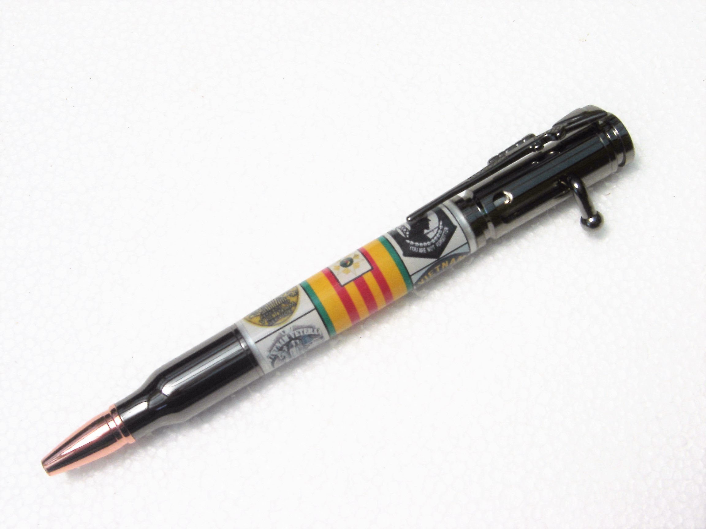

30 Caliber Bolt Action - Gunmetal Pen - Vietnam Ribbon.

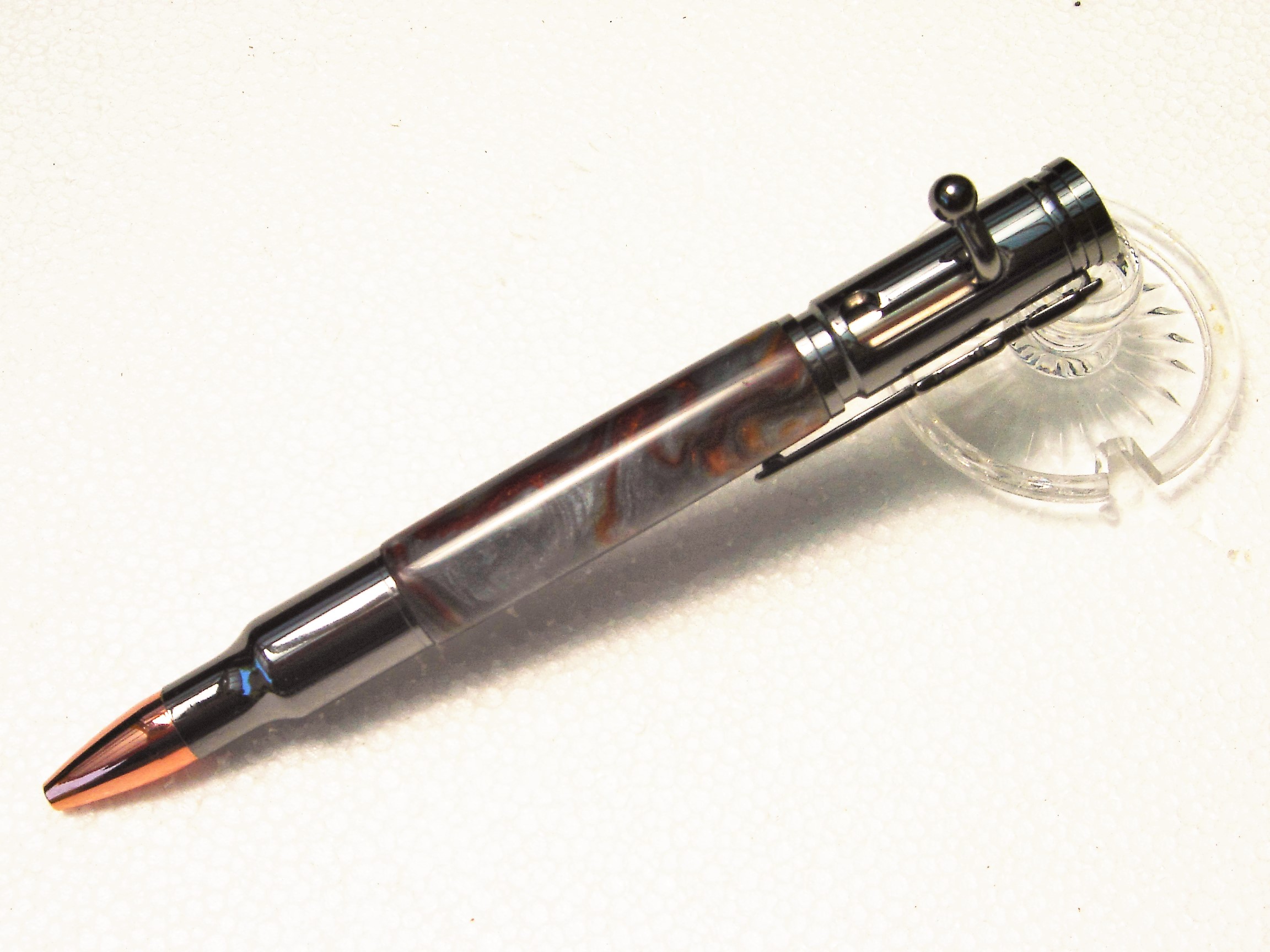

Bolt Action Magnum - Gun Metal - Molten Metal Blank.

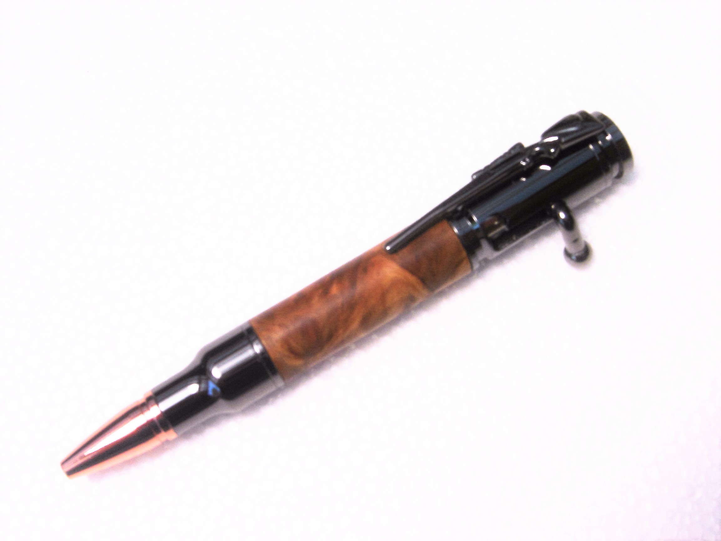

Mini Magnum Bolt Action - Gun Metal - Brown Mallee Burl.

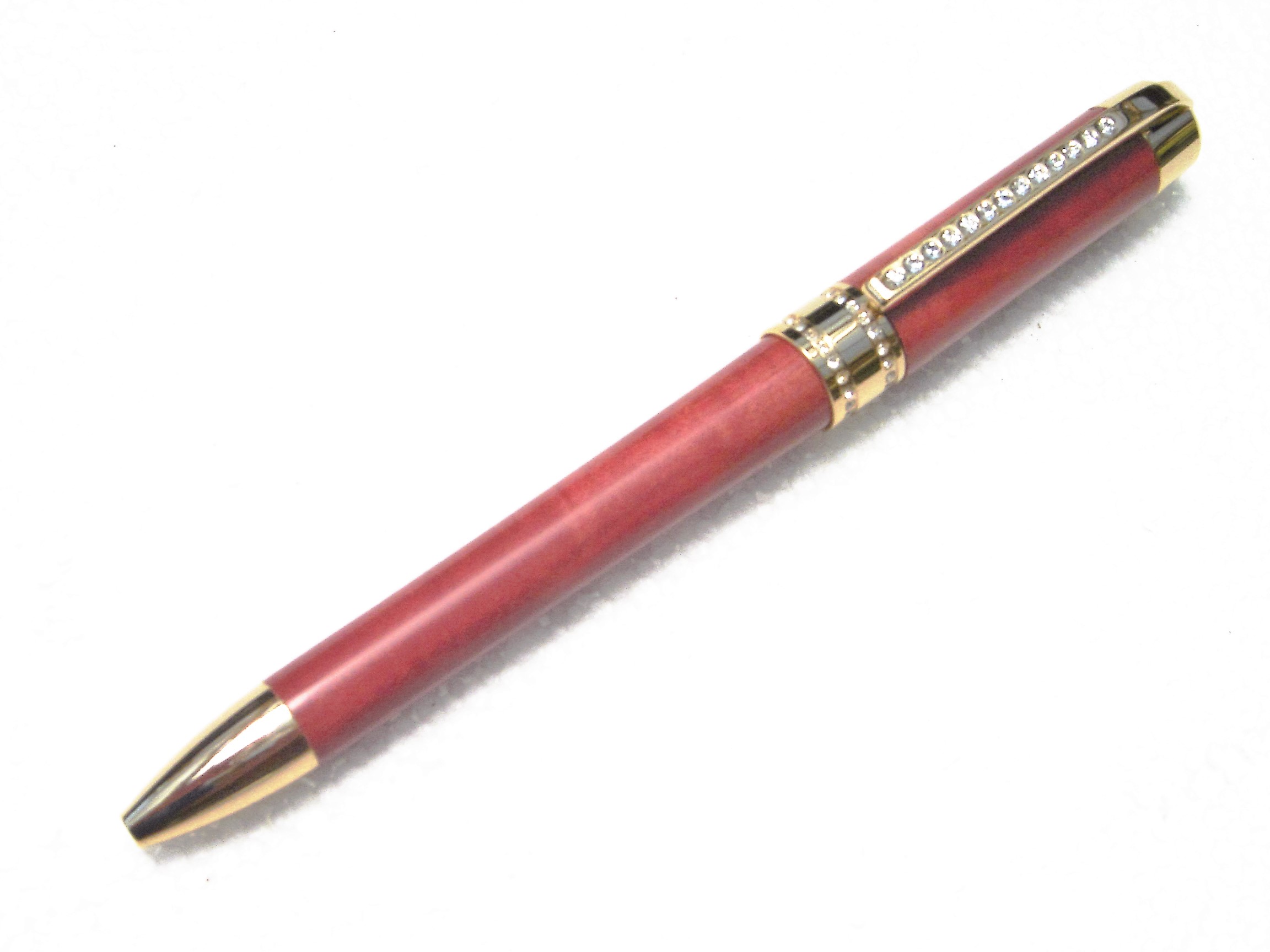

Gold Princess Pen w/ Clear Swavorski Crystals - Pink Ivory Blank.
