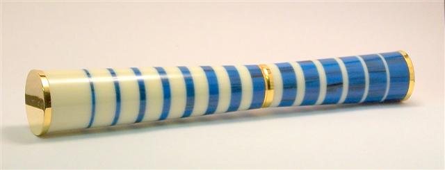

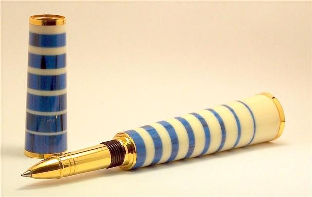

I can't remember the name of the blue stuff ( perhaps malachite?) but the white is alt ivory. This design is my wifes. I didn't like it at first, but now I think it's ok.

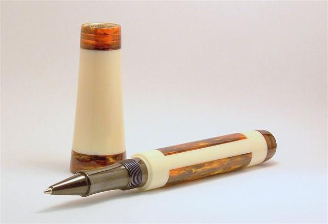

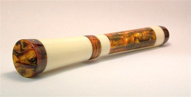

Here I'm just playing around with an old kit nib. Alt ivory and antique gold acrylic.
Comments and critisism welcome[8D]

Originally posted by R2
<br />Gorgeous pens. The blue and white is particularly attractive.[:)][:)][:)]
Actually it reminds me of my mothers old milk jug![:D][:D]
The blue and white milk jug could be original Cornish Ware, very very collectable now[;)]

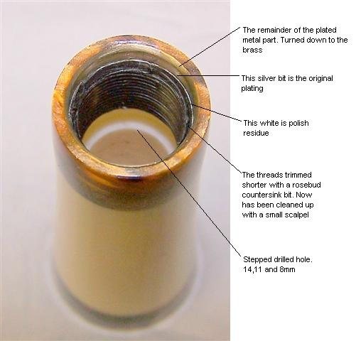

I got a couple of e-mails about the threads in the cap, and as Chuck Key has asked here, I'll try and explain.
I took the normal insert that was from same pen as the nib. The plating was worn through.
I pressed the insert into the cap tube then turned all but a tiny shoulder off of the metal. The insert was then flush with the tube. The shoulder would still stop the insert from being pushed too far into the tube. I then discovered that I didn't have the correct drill for the tube (14.5mm) I do have a 14mm so I used that, and did away with the tube altogether. There is plenty of material in this cap to support the threads even without the tube.
I also step drilled the cap. To make the pen and cap close flushly, I put the small shoulder on the pen ( this also got rid of the abrupt diameter change) Now I had to shorten the threads in the cap so the pen would go all the way in. I just used a a countersink bit by hand.
Here's a pic I've just taken,

I absolutely LOVE the first pen!!
Very well done. Tell your wife she came up with a winning design.

Steven: Nicely done. Both pens outstanding. My personal preference is for the gold and white. I like to color combination and the shape.
A suggestion if I might. The big chunk of white at the end of your wife's pen caught my eye immediately and sort of unbalances the symmetry of the pen. Looks like you ran out of length and put in a double layer/thickness of the ivory to fill up the length. If you ever make another pen of similar design, you might want to think about keeping the white layers all the same or similar thickness. (Just on the while end.) Reduce the thickness of the thick white segment by half and add another white segment at the other end of the pen(at the nib) to compensate for the loss. some might not agree; but i think that modification would improve the overall look of the pen.

Randy, you are correct, but it was a bit of a compromise. All the segments are 0.5mm less than the next same colour with the exception of that one. I played around for ages trying to get the balance right, for the whole pen and cap. The cap was easy, as I just trimmed the tube fractionally to make them fit. There was too much on the white end to trim but not enough to add one more thinner blue one.
the smallest stripes are 1mm. I tried to do 0.5mm ones, but they kept breaking as I parted them off.

Just back from a show, so thought I would tell you that closed end version is actually NICE. (I think the penache is WAY too big - so this is a REAL compliment). The blue and white effect is also cool, but the kit is huge - not your fault, I just don't care much for it.
IF you happen to have a pic of the "closed end" standing up, please e-mail it to me - this COULD be my future use of the kit.
<br />Could not disagree more Randy. Perhaps if you take another look at the overall design you will see why steve has done the pen that way.
Hey Russ: I did take another look at the pen after my first post and realized that some of what I suggested was a little off target. It did escape me, originally, that the pattern was a single pattern carried through the full length of the pen rather than be restricted to each of the two individual parts. I had intended to revise my original comment; but got interrupted and never got back too it. Nonetheless, I stand by my original comment that the one white piece is too large and detracts from the visual balance of the pen.
Steven: These little mechanical conundrums are fascinating to me. I did a little math work on your design and an Autocad drawing to see what would fit the Panache and was totally frustrated as nothing would work. I just reread your original post and discovered that you were incrementing in 1/2 mm steps. I was doing my calculations in 1 mm increments.[:(!] I'm going to go back and redo the work and see what kind of solution develops. There has to be a way to make this work.
Just to make sure I fully understand your pattern, could you conform a couple of things for me.
1. Do you recall how much you shaved off the cap tube.
2. Do you recall the approximate length of the one long white piece that got this discussion started?
3. The thinest layer is 1mm thick and each layer increases by 0.5mm. There are 14 layers of each color and the thickest layer would be 7.5mm excepting the bigger white one.
