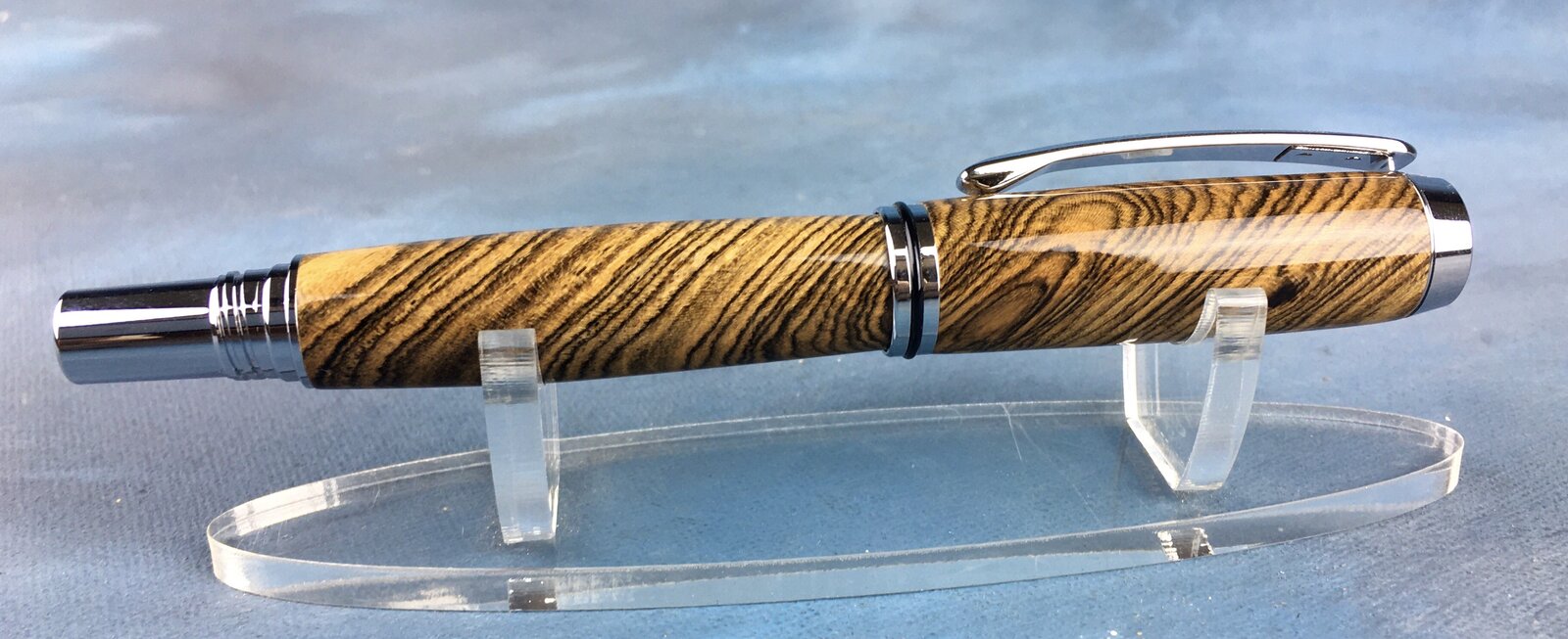

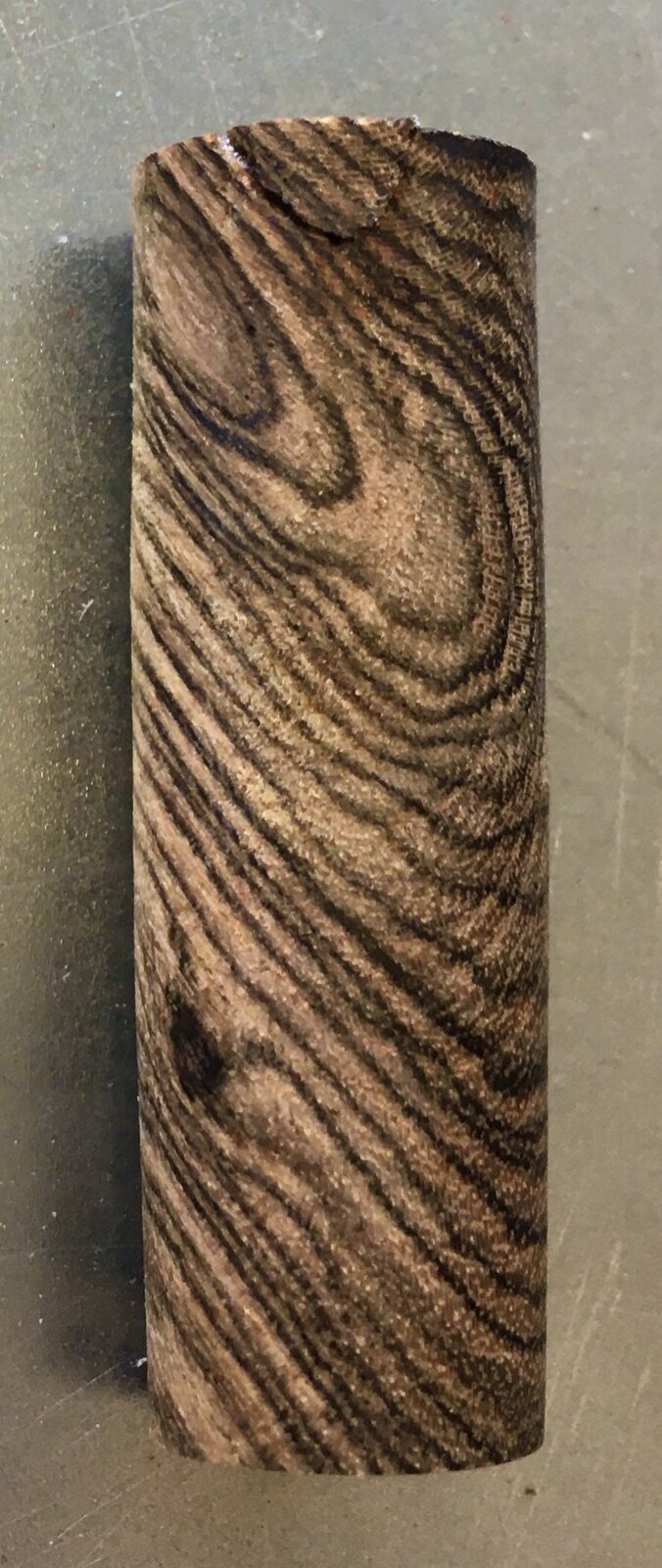

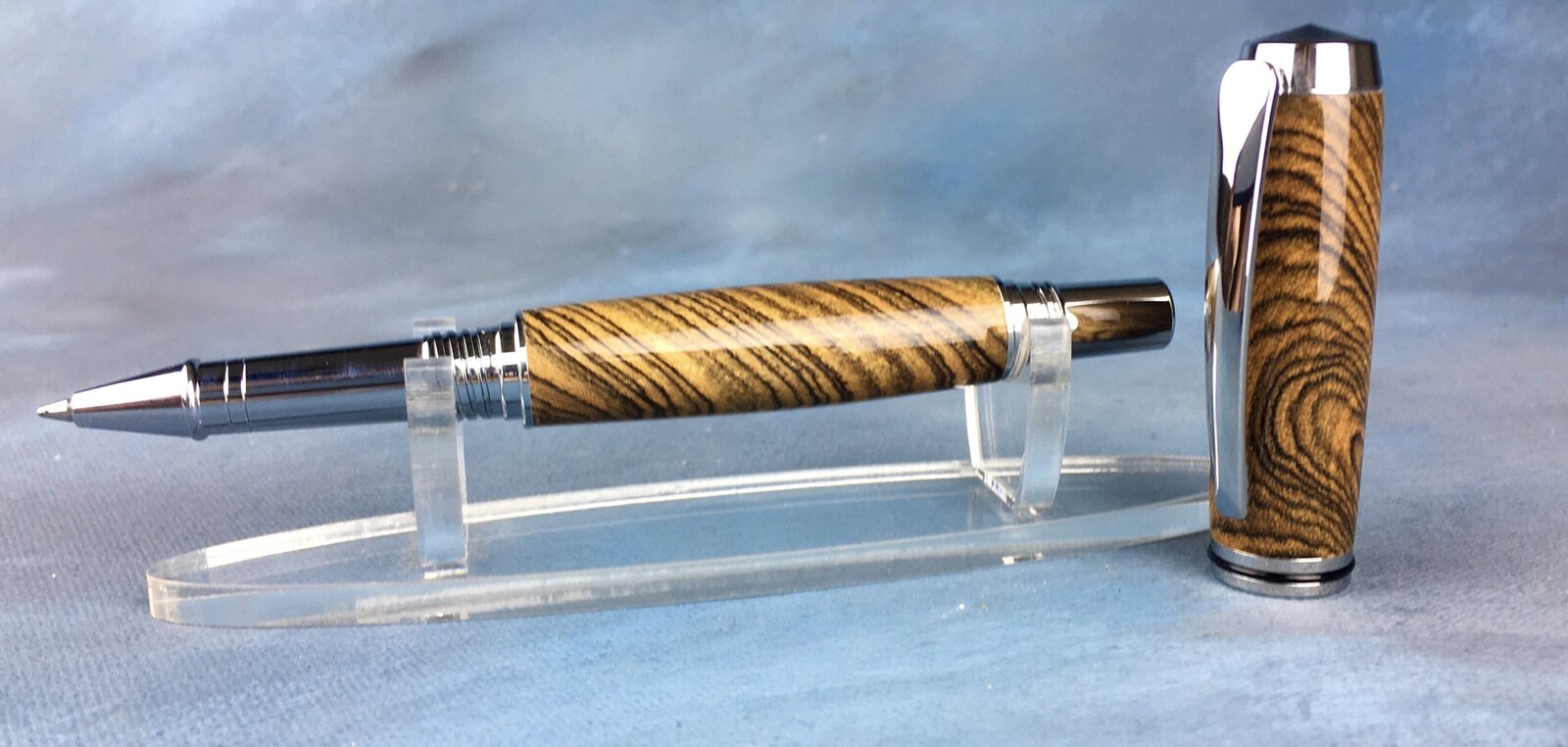

I was turning this pen today, doing all the things you are supposed to do to prevent chip out and just at the end - bing. I was just about to toss it since the chip was a highly figured 1/4" triangular piece. Finding such a piece in my shop borders on insanity, but I gave it some time on my knees. I found it and carefully glued it back with thick CA. I then flooded the region with thin CA and sanded (head down) to the right size. It might be hard to see but it worked. I did not even try to hide it under the clip as the grain match took priority.

Nice save !! . Looks really good !!
WOW ! . Lovely grain, indeed !! . What wood is it ?
Very well done! Love the wood and finish as well--what did you use?

Nice save! Incredible finish - what do you use?
4 coats of thin CA, light spray, 12 coats of 50 CPS "pen finish" with a light spray after each. Sand with 400 grit and buff on the Beale buff.
Aug 13, 2016
1,460
Surprise, Arizona
That beautiful wood is only topped by your ability to save it. Even seeing where the chip out occurred, it's all but impossible to notice it in the finished piece. I doubt one would without seeing the first pic. Very nicely done.
