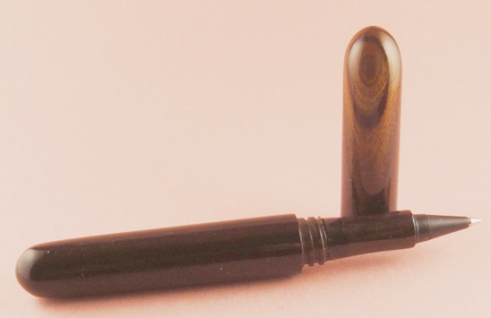

If a picture is worth a thousand words
mredburn
IAP Activities Manager
Staff member
Jul 5, 2009
8,754
Fort Myers FL

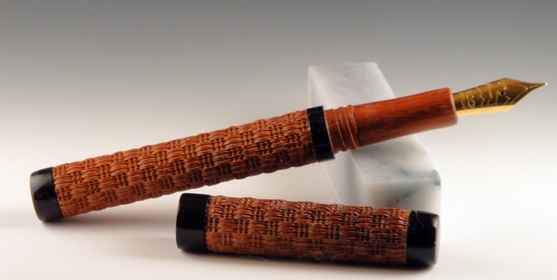

For the roller ball nose cone I use a brass threaded insert. for the cap threads I thread the wood.
The brass insert in the back ground, m8x1. The ebony on the front of the walnut is threaded inside and out. Inside is m8x.1 and the outside is m12 x.75, you might beable to see the threads on the inside of the ebony in the second picture. they are then glued on to the pen. I cut a short tenon to the tube about .025 deep.

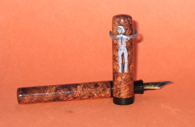

So now we have seen fine threads by Mike and I think hand cut coarse threads by Bruce. So now you know that it is not only possible in theory but by the photos it has been accomplished. Now you need to realize that Mike and Bruce are two of the more talented people on here and know their craft better than most. These are the things that many strive for, no because you don't have to buy a kit but because you want to test the limit of their talents and take things to the next level that you cannot achieve making kit pens.
