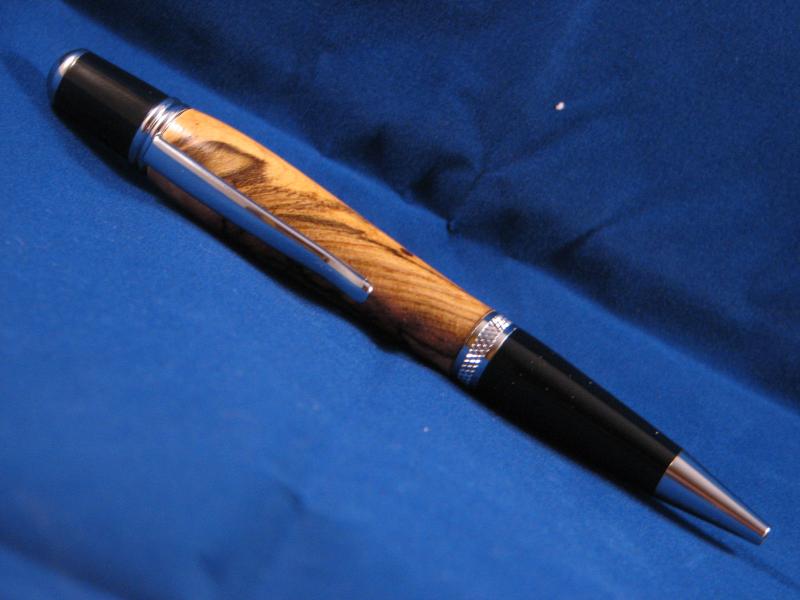

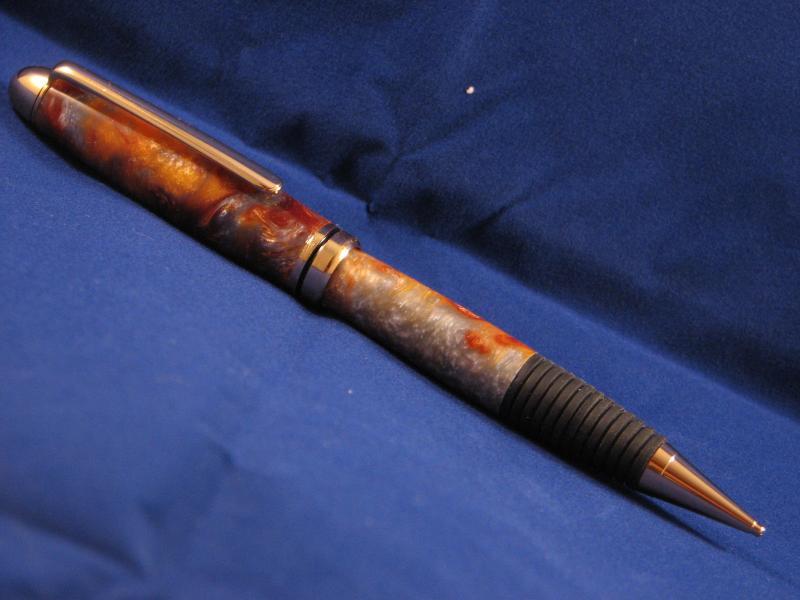

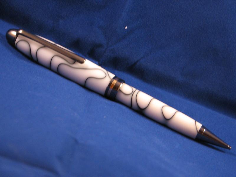

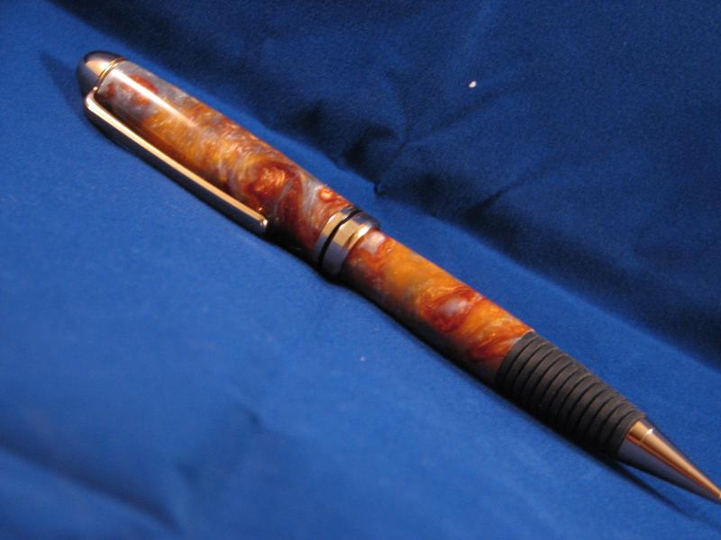

I did these over the past couple of days. the first is a Sierra with Spalted Hackberry, my first decent CA finish. the second is a Designer twist Pencil in a White & Black Lava, and the last two pictures are the same pencil another Designer Twist Pencil in Molten Metal. The Molten metal is pretty chippy but so beautiful, a piece chipped off at the end of course that I couldn't fix so I cut it back and used one of those rubber grips I've saved from a comfort pen and it works. Both of the pencils are for two of my kids who wanted me to make them a pencil, like most of you I'm sure, my kids carry some pretty nice pens........lol :biggrin:

Inside the cent ring, at the nib end, is there a small tenon (maybe only 1/32" deep)? I like to cut the lower half of my pen bigger than this inside of teh cent ring, then cut a tiny tenon in the pen to key into this. It makes it very hard to tell which part of the pen has the cent ring attached.

Yes, the designer twist Pencil is tweaked, its a standard PSI kit but the original barrel cracked and chipped so I cut it back and I used a saved rubber grip to fix it. It works, my son thinks its special so its a win win situation.
